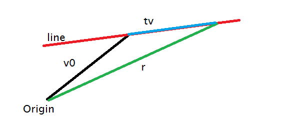

The vector form you showed above is lots more intuitive to work with than your example with the two equations. Using the vector parametric form, draw a vector from the origin in the direction of ##\vec{v_0}##. Its magnitude gets you to a point on the line. To get any other point on the line, choose a value of the parameter t, and extend a vector along the line to the point in question.
Here's a picture to help get the idea across. I did this in Paint, which doesn't have many capabilities for nice text. By vector addition, you should be able to see that ##\vec{v_0} + t\vec{v} = \vec{r(t)}##.
The two equations in your example represent two planes that intersect in a line. Think about the effort you would need to expend to get a single point. Even so, you wouldn't have any idea about the direction of the line.
