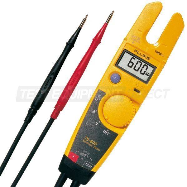

ok a very crude example of something I'm looking for is this.
5-Electrical-tester-with-OpenJaw-Current-Check-Voltage-Continuity-and-Current-600V-1000V-AC-Free.jpg
I don't even know what this is and I'm pretty sure it just tests to see if something is live. But I want something that looks like that, where I can plug it into my socket at home, turn the dial to say 1mA and then when you touch the prong you will get a 1mA shock. Again ignore the image I just grabbed something that I thought such a device might look like

This is just another meter like the first one you posted and meters MEASURE things, not control them.
EDIT: that is, you are looking at meters in general, which is not what you want. Very expensive power supplies can be had that have a current-limit feature, as well as a voltage adjustment. To get something that feeds you wall socket voltage the way you want, you would need to build a current-limiting circuit.

Thanks. I know the image is just a reader but hopefully that gave you a sort of idea of the thing I'm after. I just want something that allows me to set the voltage and amperage of the electricity flow so I can connect a piece of copper and now that copper wire carries the exact voltage and amperage that I set on the machine.
