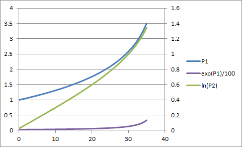

Cyrus said:
Good point, it's actually e^(p1 - c_3)
Which is a negative exponential, but we can rewrite that as e^p1 / e^c_3 so I left out the denominator since it was a constant value. c_3 is just a constant
Still explodes, at some point P1 > c3.
Let C3 = 100 and P1 start at 1:
Likes jim mcnamara
It looks like you have, for a fixed data rate
##\Delta P = e^P,## so ##P_2 - P_1 = e^{P_1 } \Delta t##?
In the same way you simplified the first problem,
##\frac{\delta P}{\delta t} = \frac{ P(t+\delta t) - P(t) }{ \delta t} = e^{ P(t) }.##
In the limit, this will give you ## P' = e^{P(t)} ##
As BvU has pointed out, no matter what your starting P_1 is, your function will eventually blow up. Is there some other context for this problem? Maybe some initial values?
