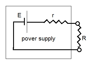

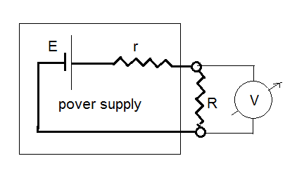

Yes, you are on the right track. See figure. The box represents the real power source, an ideal source with EMF E, and the internal resistance r, connected in series. The current flowing through the circuit causes potential drop across the internal resistance, so you get voltage across the terminals which is lower than the EMF.
In this problem, the resistance of the voltmeter is the load. The voltmeter measures the voltage across its internal resistance.

Draw a diagram and see how internal resistance and voltmeter resistance are connected.

The voltmeter shows the voltage across its terminals. It depends on the loading resistance and also the on the internal resistance of the battery. You said that E=I(r+R), and you get the current I=E/(r+R) flowing in the circuit. That current causes voltage on the resistor R, U=IR according to Ohm's Law. That is the voltage measured by a voltmeter. The same current flows through the internal resistance r: the voltage across it is Ir. The voltages add up, and their sum is equal to the EMF, according to your equation E = I(r+R) = Ir + IR. The first term is the voltage across the internal resistance, r, the second is the voltage across the external resistance R. As ##I=\frac{E}{r+R}##, the voltage read by the voltmeter is ##U=RI=R\frac{E}{r+R}##. You see, it depends on both resistances.
moenste said:
Why does it cause voltage drop along the internal resistance of the battery?
The current flows through the internal resistance of the battery, and a current I flowing through a resistor means that there is voltage drop across the resistor. It is Ohm's Law. Or it is better to say, that the current can flow through the resistor only when there is potential difference between the terminals of the resistor.

The current I flows through the internal resistance r of the battery. What is the voltage across r? Read the first paragraph of my post.

The voltage across the terminals of the voltmeter (they are the ends of the cables) is less than the EMF of the battery by 5000 - 40 = 4960 V.

In general, the voltage across the internal resistance of the battery is Ir, and the potential difference across the terminals of the loaded battery is U=E-Ir, which is equal to the voltage across the external resistance, IR.
