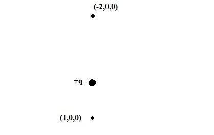

Below is a graphic representation of the problem.
With a point charge at the origin, calculate the difference in potential of point B relative to point A using the path integral.
As I recalled, to find the electric potential difference, Vab = - ∫ E ° dl (° = dot product)
Potential difference for point charge: V = Q/ 4πεr
Vab = Vb - Va
Electric field for point charge should be, E = Q/4πε(R^2)
I am not sure what is meant by path integral. But I will try to do it but not sure the correctness:
Since there is one point charge, and it is located at the origin. SO
V = -∫E°dl = -∫(Q/4πε(R^2) ) dr
V = Q/4πεR + C
I assume zero potential at infinity. If V(∞) = 0 , C = 0.
At point A, potential difference will be:
|r - r1| = |(0,0,0) - (1,0,0)| = |(-1,0,0)| = 1
V(1,0,0) = [1/ 4π(10^-9 /36π) ] *[q/1]
At point B, potential difference will be:
|r - r2| = |(0,0,0) - (-2,0,0)| = |(2,0,0)| = 2
V(-2,0,0) = [1/ 4π(10^-9 /36π) ] * [q/2]So for the difference in potential of point B relative to point A using the path integral, I just do V(-2,0,0) - V(1,0,0)?
Please tell me if I am doing the correct step. This is very important. Thank you
You get the work as the negative potential difference, but calculate it with the line integral this case. Integrate the electric field strength between the points along any line. (A straight line is the simplest).
What do you mean on [1/ 4π(10^-9 /36π) ]? Is it k=9.10^9? ehild
yea , that is k. And why do we need to find W first? Can we just find V by using V=-∫E.dl ?
I meant work on unit positive charge: ∫E.dl=-ΔV
