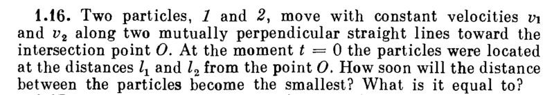

A)
Mean velocity is defined as <v> = total distance traveled/ total time taken = πR/Γ = 0.5 m/s
B) How is part a) different from part b)?
I think what Irodov means by mean velocity is mean speed in part a.
It is mean speed which is defined as <v> = total distance traveled/ total time taken .
In part b,
<v> is defined as <v> = total displacement traveled/ total time taken in the direction of total displacement
|<v>| = R/Γ = 0.32 m/s
Have I understood the difference between mean velocity and modulus of mean velocity vector properly?
How to calculate part c?

I am not sure about this terminology, either. But if you go halfway around the circle, your displacement will be the diameter of the circle, not the radius.

I think he means what he says -- mean velocity. Which is a vector.
Part B is then trivial -- take the magnitude of the vector.
Part C...
The question implies that it does not matter what tangential acceleration is as long as it is constant. So cheat and assume that tangential acceleration is zero.
Yes, I calculated that way , but didn't write 2 before R. Thanks for pointing it out.
So, |<v>| = 2R/Γ = 0.32 m/s
It is a bit odd, but part b seems to be asking for the magnitude of the vector found in part a.

Pushoam said:
I feel that by the term" mean velocity", Irodov means "mean speed "
Ah, I see. He writes v for ##|\vec v|## and v for ##\vec v##. Then yes, qn a is asking for mean speed and your answer is correct.
For part c,
Taking the constant tangent acceleration to be 0,⇒ speed is constant ⇒ mean speed = instantaneous speed
<w> =( vf - vi )/ Δt
= (v##\hat y## - v## (-\hat y##))/10 = 2*0.5/10 = 0.1 m/s2 ##\hat y##
| <w>| = 0.1 m/s2
But, how to show that this is true for any constant tangent acceleration?
I suspect the question intends that it starts from rest, so the tangential acceleration is not zero.
It is not said so in the question.
Nonetheless, I will try to solve it for non-zero constant tangent acceleration.
Taking the constant tangent acceleration to be c.
speed v = ct + vi
<v> = (1/τ)∫0τ(ct + vi)dt
= (cτ/2) + vi) = 0.5 m/s
= [ (ct + vi)##\hat y## - vi(- ##\hat y##)]/t
Taking vi =0,
cτ/2 = 0.5 m/s
So,| <w> |= c = 0.1 m/s2
How to solve it with non - zero vi?
<v> = (cτ/2) + vi = 0.5 m/s
2 vi = 0.1 - cτ
|<w> | = [ ct + 2 vi]/τ = 0.1 m/s2Is this correct?

Thinking about it some more, that assumption is unnecessary.

Your method has found the constant tangential acceleration, but that is a scalar. The question (this time) clearly defines the acceleration sought as a vector.
Suppose the initial speed is vi in the positive x direction. What is the final speed, and in what direction? What is the change in velocity?

Even if you take constant tangent acceleration to be a vector, then this vector can't be constant as tangential direction itself goes on changing.
So, by constant tangent acceleration, what Irodov means is the magnitude of the tangent acceleration is constant.
Because of this acceleration, the speed will go on changing.
So, I have to calculate final speed.
Now, the direction of final velocity is opposite to the direction of the initial velocity. This is what I have donein #13.

It tells you the tangent acceleration, ##\frac{d|\vec v|}{dt}##, is constant, but asks for modulus of the average total acceleration, ##|\frac{\vec{\Delta v}}{\Delta t}|##
##= [ (ct + v_i)\hat y - v_i(- \hat y)]/t##
Ok, but the distance and time information you are given creates a relationship between vi and c. Try eliminating one from that expression.

I have done it in #13.
2 vi = 0.1 - cτ
I'm very sorry, I didn't read it carefully enough.
I saw
and mistakenly assumed you had not found a way.
Yes, your answer in post #13 is fine.
