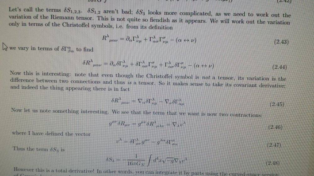

My notes seem to imply this should be obvious :
If i consider the covariant deriviative then i get something like
christoffel= nabla ( cov derivative ) - partial
So difference of two of them will stil have the partial derivatuves present ,assuming these are labelled by a different index ? Whereas a difference of cov derivatives would ofc transform as a tensor i don't see how here with the partials
