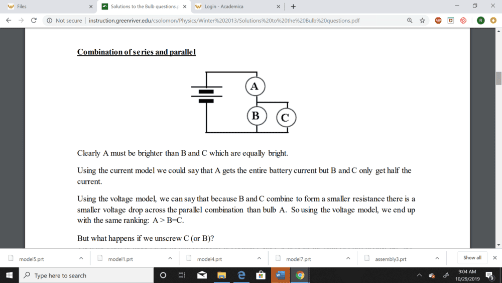

I came across 2 similar example problems while studying for my exam and I want to make sure I get the differences between the two before I take my test later this evening. (This might be long but I have an exam coming up and I don't want to go into it with any uncertainties. I appreciate anyone who reads through it and corrects me where I'm wrong in my understanding)
So, the example in the first screenshot I get. Bulb A gets the full current of the batter. After exiting bulb A, the current reaches a node where it splits up, so B and C will be equally bright, but less bright than A because of the reduced current going through them (P = VI). Also, because B and C are in parallel, they combine to a smaller resistance. The equivalent bulb (lets call it bulb BC), will have a lower potential drop across it than bulb A (V = IR, lower resistance means lower voltage, and lower voltage means less power aka brightness). If C is removed, then the remaining bulb B will now have a higher resistance across it now that the resistance from bulb C has been removed. This higher resistance means a lower current running through the circuit ( If B now has a higher resistance with the absence of C, A and B are now in series so the resistances add up, meaning a higher total resistance in the entire circuit). So both B and A will be dimmer than before (with B being brighter than A because of the higher resistance)

In the first picture, you got everything right except for unscrewing. Assuming that all three bulbs have the same resistance, once you unscrew bulb B or C, you will get same current and resistance through the remaining bulb, so it will shine as bright as A. Now the total circuit will have higher resistance than before, so both bulbs will be dimmer than before, but they will shine the same(B will not be dimmer than A). That is providing they are all the same bulbs, which I assume is the case.
