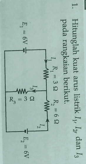

To demonstrate effects of different sign conventions above, I attached sample problem
from this homework forum. The problem image:
By standard sign convention, the equations are:
$$\begin{align}
I_1 + I_2 &= I_3 \nonumber \\
6 - 3I_1 - 3I_3 &=0 \nonumber \\
6 - 6I_2 - 3I_3 &=0 \nonumber
\end{align}$$
Solving the equation, we have ##I_1 = \frac 4 5 A, I_2 = \frac 2 5 A, I_3 = \frac 6 5 A##.
By flipped sign convention, the equations are:
$$\begin{align}
-6 + 3I_1 - 3I_3 &= 0 \nonumber \\
-6 + 6I_2 + 3I_3 &= 0 \nonumber
\end{align}$$
Solving the equation, we have same solutions as above with standard convention.

They are conventions. There is no right or wrong involved. Either works, you just need to be consistent. The only time you will have a problem is if you switch conventions in the middle of a problem.

Sorry for the typo/sign error from second equation from "flipped" convention one. What I mean is ##-6 + 3I_1 + 3I_3 = 0 ##.
