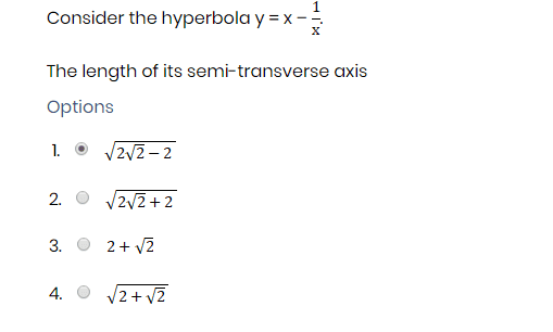

The question along the answer is given in the attachments. What I seek is the explanation.
---not sure---
I know the hyperbola of the form x^2/a^2-y^2/b^2=1 and xy=c; but coming across this question I'm put in a dilemma of how to proceed with calculating anything of it - say eccentricity or latus rectum or transverse axis as said. How to generalize a hyperbola (but i don't want a complex derivation of hyperbolas because that's out of my understanding, i want to get across these questions; teach me the fundamentals) and find it's different values or parameters?

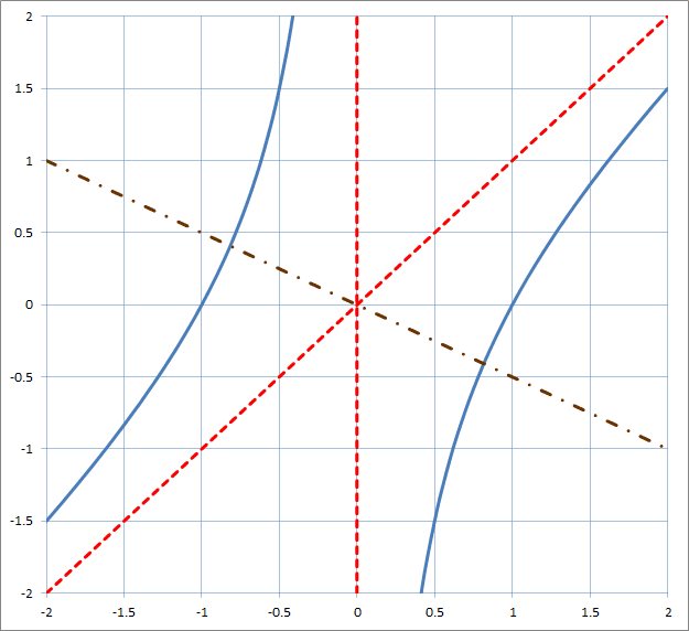

In that case you can fall back to a very useful action: make a sketch like I did:
Blue is your hyperbola, red is the asymptotes and on the brown line is the transverse axis.
With such a nice :cool: sketch it is clear what you need to do to calculate the required value !

Gourab_chill said:
how do I know what is the equation of the transverse axis?
You are not asked for the equation, only the length.
You can see from @BvU's beautiful sketch that it's the closest approach to the origin. Just a little calculus...

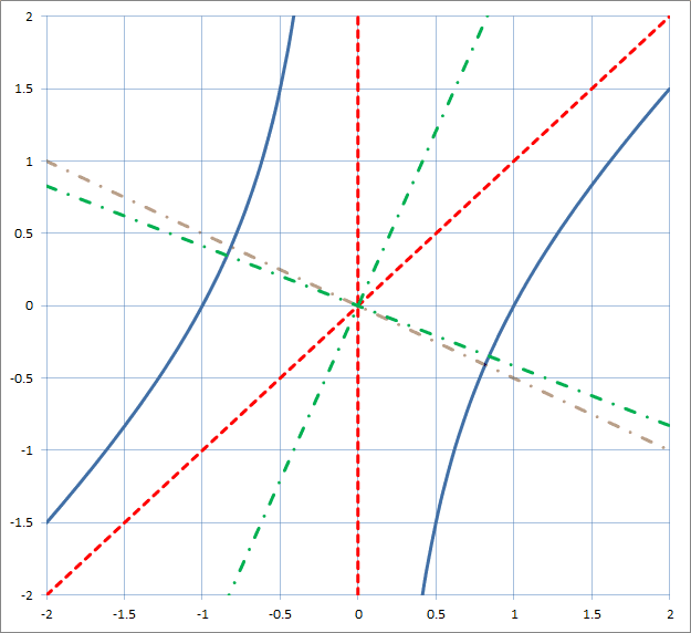

BvU said:
Then you can also find the line for the transverse axis
The brown line is a bit too suggestive, going through ##(1,-0.5)##.
The green dash-dot lines represent the correct axes:
So you'll need an intersection of the green line and the hyperbola.
Not by coincidence the slope of that green line is ##\ -\tan(A)\ ## in @SammyS post #9
Likes Gourab_chill and SammyS
