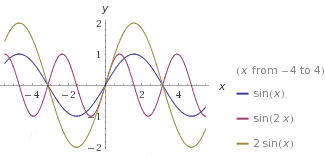

Check out the graphs:
cd98f00b204e9800998ecf8427efi199hvhk6&f=HBQTQYZYGY4TSM3EMI3WENBTHAYDCNBVGU3DEMTEGA4GEMZXGEZAaaaa.gif
To put a 2 in front of sin x is to double the amplitude. To put a 2 in front of the x in sin x is to double the frequency.
