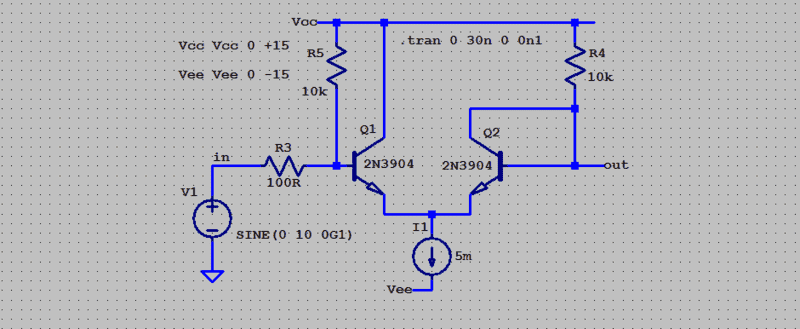

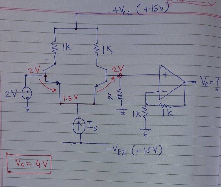

Find the Op-amp output voltage Vo in the following circuit.
Vout= Vin(1+Rf/R1) for non-inverting input.
Here is the circuit diagram provided in the book.
In the solution, the book has used the following approach (red markings in the image):
Input to the left transistor is 2V. Considering base-emitter junction drop to be 0.7V, the emitters are at 1.3V (left red arrow). Now, using the "virtual short" concept, the base of the right transistor is also pulled to 2V.
As the non-inverting terminal of op-amp is at 2V, using Kirchhoff's rules and the feedback equation, Vout=4V.
But how is the base of the right transistor pulled to 2V? Is the concept of "virtual short" really applicable here? As per my understanding, the right transistor should be cut off.
What is wrong here?
That is correct for the circuit as shown.
cnh1995 said:
What is wrong here?
Everything. It seems like a useless circuit because there is no feedback from the op-amp to bias the transistor base on the RHS.

If the two transistors are matched, the DC bias voltage, and the magnitude and direction of the current source are set correctly, then we should get the desired effect, which is the same base voltage for both transistors.
Where does the base current for Q2 come from?
Likes DaveE, berkeman and alan123hk
To cnh1995:
"Now, using the "virtual short" concept, the base of the right transistor is also pulled to 2V."
Why do you expect that the base of T2 will be "pulled" to 2V ?
There is absolutely no reason for such an effect. The "virtual short" effect applies to active devices with very large gain and negative DC feedback only.
Yes, you are right, I missed that, the base current of Q2 can be provided by the ground resistor, but the input voltage must be kept below -0.7V.
Since this circuit requires an input voltage of 2V, a voltage source greater than 2V is required to supply current to the base of Q2.
I believe there must be three or more errors in the schematic.
The circuit would be more useful, easier to model and understand if;
The voltage source for the base of Q1 was negative two volts.
Or the transistors were N-channel FETs.
And the polarity of the conventional current source was reversed to become a sink.

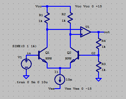

In your circuit, for a suitable bias point, the DC current through each transistor should be app. 5mA.
That means: A current source of 10mA in the common emitter lags.
In this case, the unsymmetrical voltage gain (collector T2) would be A=-0.01*10³=-10.
Hence, the input signal at T1 must not be larger than app. 100mV.
Question: What is the purpose of the opamp? To provide additional gain or something else? Perhaps it should be connected to the collector of T2?

The problem is not from any standard textbook. It is from a collection (booklet) of analog electronics problems for certain national/state level entrance tests in my country. So the purpose of the op-amp could just be to increase the difficulty level of the problem.
I ran a simutaion of this circuit on my phone and it shows that Q2 (right transistor) is indeed cut off.

Yes, it is connected to the base and not the collector of T2.
The purpose of the op-amp is not mentioned in the problem. Seems the book's solution is incorrect.

I think it could be interesting to discuss the properties of the shown circuit - in particular when it is compared with the classical four-resistor opamp based differential amplifier (advantages, disadvantages).

First, I assume that you mean the diff amp circuit that should have been shown, one that actually works. Look at @Baluncore's schematics for this.
Second, That diff amp stage IS Link Removed, in various incarnations. So I would reinterpret your question as what are the pros and cons of having a separate discrete input stage vs. integrating it with additional amplifier bits.
BTW, it sounds obvious that you would put it on the IC silicon, but there are times, like low noise circuits, when you mighty actually do what @Baluncore showed.

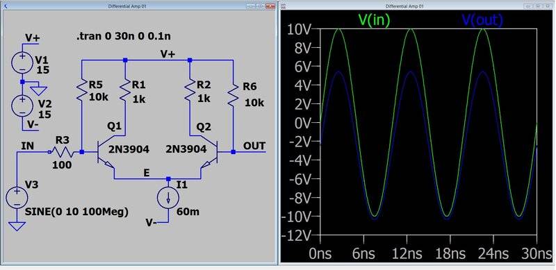

I'm interested in revisiting the incomprehensible circuit mentioned at the beginning of this thread. As I mentioned before, if you apply a proper bias voltage, you can make the base voltages of the two transistors very close, as shown below.
This differential amplifier has high input impedance over a wide frequency range because the impedance of the current source is infinite.
On the other hand, it can be seen that its output (Q2 Base) remains very close to the input over a wide voltage range up to 100 MHz, although the DC level is slightly shifted and the amplitude is reduced. But unfortunately in the end this electronic circuit is still meaningless and cannot be called a follower because its transistor base output impedance is surprisingly high. :frown:

  • #34
Baluncore said:
What is the purpose of R1 and R2 ?
The circuit would respond even faster if you removed them with their miller capacitance.
Sorry I didn't think about this, the original circuit had these two resistors, so I didn't specifically think about what they were doing in my new circuit, so they stayed.
My main point is that if you want the base voltage of both transistors to be the same, it's not too hard.

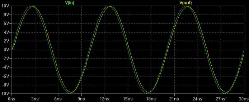

When I remove two resistors, and reduce the bias current from 60 mA to 5 mA, I get;
39
