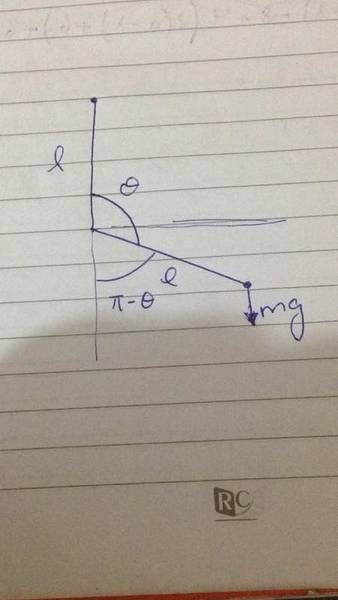

A simple pendulum is formed by a light string of length ##l## and with a small bob ##B## of mass ##m## at one end. The strings hang from a fixed point at another end. The string makes an angle ##\theta## with the vertical at time ##t##. Write down an equation of motion of ##B## perpendicular to ##OB## and state the approximation that enables you to treat this equation as an SHM equation. State the general solution of this equation.
Equation of motion : ## \rm \large -mgl\sin(\pi -\theta) = ml^2 \ddot \theta##
Rearranges to: ## \rm \large \ddot \theta =-\frac{g}{l}sin(\pi-\theta)##
Approximation: ## \rm \large sin \theta \approx \theta## provided ## \theta ## is small.
General solution: ## \rm \large \theta = \theta_0sin(\sqrt{\frac{g}{l}}t)##
Are my answers correct?
The reason I am confused is because I think I have misunderstood what they mean by "equation of motion of ##B## perpendicular to ##OB##" and may have got all of my answers wrong.
And secondly I am well aware of finding a general solution of a differential equation of the form ## \rm \small \ddot y =ay ##, however, I have never seen a general solution of a differential equation of the form ##
\rm \small \ddot y =a(\lambda-y) ## where ##\lambda## is a constant.
It is not entirely clear what you are calling theta (and thus why you have involved a pi - theta argument for the sine). A figure would really help your question, along with labels on the figure.
As to the solution for the differential equation, did you really mean ddy = a*y, where a is presumed to be positive? Or did you intend to have it be negative?
The additional term a*lambda simply adds a constant to the particular solution.
I hope this will work.

Start by replacing sin(pi-theta) with just sin(theta); they are exactly equal.
Then, with a little bit of re-arrangement, your equation should look like
dd(theta) + w^2*sin(theta) = 0
Then make the approximation that for small theta, sin(theta) = theta, so you have
dd(theta) + w^2*theta = 0
That should be the only equation you need to solve for this problem.
I really don't know where the question about a constant term on the right came from.
Okay thank you that explains a lot.
