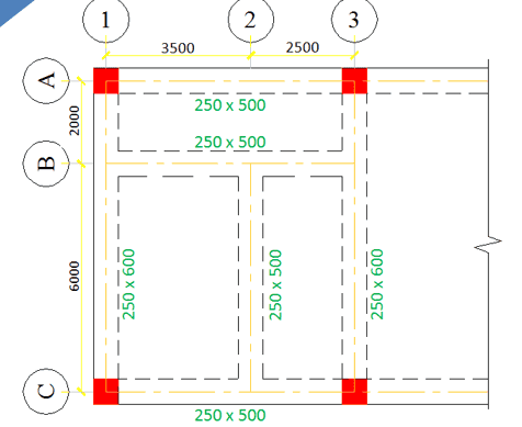

How to differentiate between rectangular beam and flange beam ? In the question below , the answer provided is flange beam , I'm wondering can i design it as rectangular beam
Since there's no clue whether the flange beam or rectangular beam , i think i can also design it as retcnagular beam . Correct me if i am wrong . [/B]

Since the question specifies that the beams and slab are cast together, can i say that the beam must be 100% flange beam ? IMO , the rectangular beam doesn't have beams and slab are cast together, am i right ?

afaik , rectangular beam doesn't have beams and slab are cast together
That's a valid observation . So you can reasonably make the decision that it needs to be a flanged beam . That is what I would have decided on as well .
Really any beam being cast directly into a concrete slab has to have features which lock into the concrete . These features occur naturally in a flanged beam but would have to be provided as extras for any type of flat sided beam .
