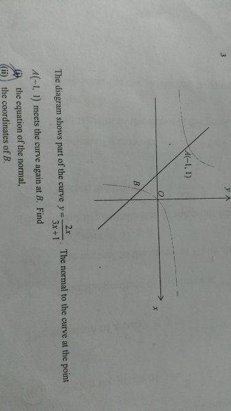

For those who don't want to stand on their heads, the problem says,
"The normal to the graph of [itex]y= \frac{2x}{3x+ 1}[/itex] at (-1, 1) meets the curve again at point B. Find
(i) the equation of the normal.
(ii) the coordinates of B."
