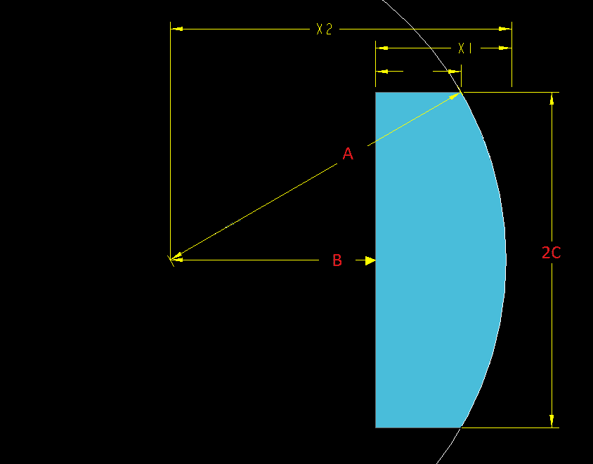

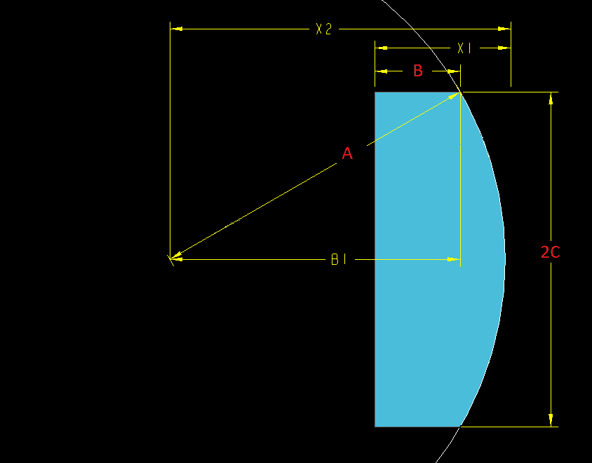

Thanks for taking the time to reply! Your first assumption is correct, that is the double integral I am working with. I am afraid variables a, b, and c are not related in any of the ways you mentioned, I'm not even sure if they have an absolute relationship. Just treat a, b, and c as independent variables. I have attached below a picture of what a, b, and c stand for so you can visualize the shape I am working with (ignore the other variables in yellow). This is part of a larger problem and I am fairly confident this double integral is the source of my error. EDIT: The picture in the attachment is wrong, the picture that is embedded is correct.
Also, I don't NEED it to be in polar coordinates, I just need a way to get an integrated solution that has variables I can change and see how it affects the final solution. Thanks for your help!

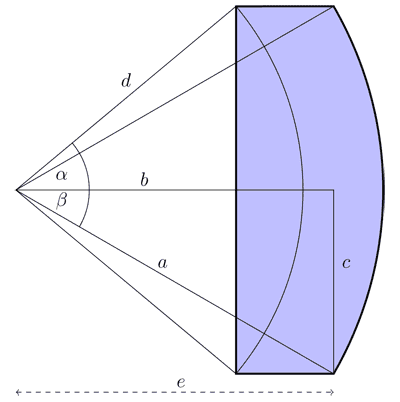

As someone on another forum suggested, you can evaluate the integral $$\int_{-c}^c\int_b^{\sqrt{a^2-x^2}}\sqrt{x^2+y^2}\,dydx$$ by transforming it to polar coordinates. You have to split it into two pieces, as in this diagram:
Let $d = \sqrt{b^2+c^2}$, $e = \sqrt{a^2-c^2}$, $\alpha = \arccos(b/d)$ and $\beta = \arcsin(c/a)$, as indicated in the diagram. Then $$\int_{-c}^c\int_b^{\sqrt{a^2-x^2}}\sqrt{x^2+y^2}\,dydx = \int_b^d\int_{-\arccos(b/r)}^{\arccos(b/r)}r^2\,d\theta dr + \int_d^a\int_{-\arcsin(c/r)}^{\arcsin(c/r)}r^2\,d\theta dr.$$ The theta integrals are easy, and lead to $$\int_{-c}^c\int_b^{\sqrt{a^2-x^2}}\sqrt{x^2+y^2}\,dydx = \int_b^d 2r^2\arccos(b/r)\,dr + \int_d^a 2r^2\arcsin(c/r)\,dr.$$ Those integrals are doable but not so quick. I'll spare you the details, but briefly what you have to do is to integrate by parts, then use the substitution $r = b\sec\varphi$ for the first integral and $r = c\csc\psi$ for the second one. The result comes out as $$\boxed{\displaystyle \int_{-c}^c\int_b^{\sqrt{a^2-x^2}}\sqrt{x^2+y^2}\,dydx = \tfrac23a^3\beta + \tfrac13ace - \tfrac23bcd + \tfrac13c^3\ln\Bigl(\frac{d-b}{a-e}\Bigr) - \tfrac13b^3\ln\Bigl(\frac{c+d}{b}\Bigr)}.$$
Putting in the values $a=2$, $b=1.2$, $c=1$ (and remembering that $\beta$ must be measured in radians!), that formula gives the value of the integral as 2.361. So I'm sorry to say that it looks as though your colleague is right and you are wrong.
