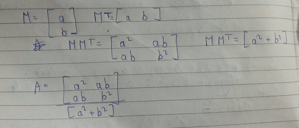

Ok so I did that but I am still stuck.
Physics lover said:
ok so I did that but i am still stuck
https://www.physicsforums.com/attachments/260171
That link leads nowhere. It can't be hard to work it out for a vector ##(a, b)##, surely?
That's good so far. Now all you need is ##A^2##.

I didn't get what you said.Shall i take numbers in matrix instead of variabled?

I calculated it but that's not matching with any option.
But how will i find A2?
Shall i find out the squares of numerator and denominator separately?
The denominator is just a number. You can leave that outside the matrix. Just square the matrix in the numerator and see what you get.
oh yes I got it.By taking (a2+b2) common I got A2=A.Thanks a lot for the help.And is it correct now?
That proves it for 2x2 matrices.
so shall i try for degree 3 too?
It's up to you. It's your question!
