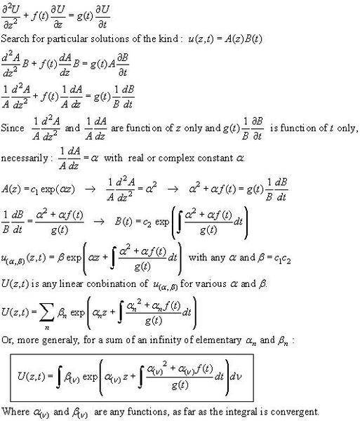

It isn't difficult to find a formal expression for the general solution of the PDE. (see attachment). As usual, the main difficulty is to find the solution fitting with the boundary conditions, among the infinity of solutions provided by the general formula.
As expected, the formal expression includes two arbitrary functions, namely alpha() and beta() with our natations.
The main problem will be to find what are thoses functions alpha() and beta() in order to fulfil the given boundary conditions. As far as the formula contains some functions, f(t) and g(t) which aren't specified, this is impossible. And even if they were specified, this would be probably very difficult, except by chance in some particular cases of f(t) and g(t).
thanks for your consideration about this matter
