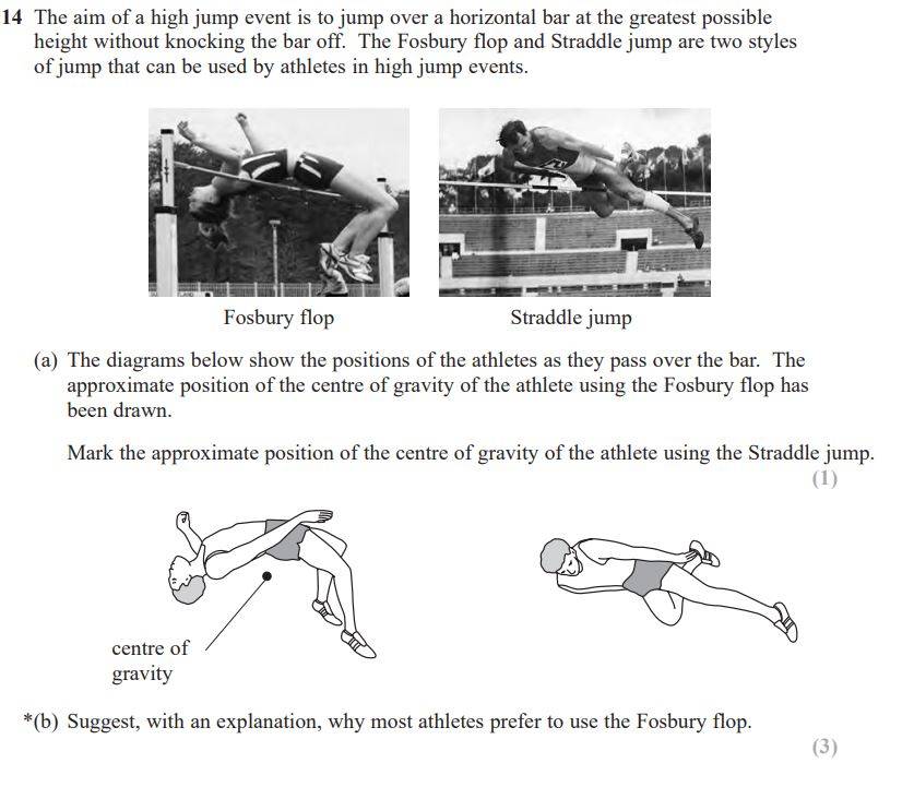

Hey,
This isn't a homework question I need help with but more of a concept I can't seem to grasp.
I understand that Centre of Gravity is: the point on a body where all the weight can be considered to act.
And I understand how to find this point on different types of bodies.
However, this sort of question has me stumped:
Part (a) is straightforward enough, but part (b) has me confused.
I can see that the centre of gravity is lower on the fosbury flop than the straddle jump but I don't get why this matters.
I've looked at videos that go over the physics of the fosbury flop and they talk about how the centre of gravity is lower than the beam that the person is trying to jump over thus making it easier.
BUT I just don't get how this works. So what if the centre of gravity is lower, why does this allow the person to jump higher?
I'm trying to find other real life examples of centre of gravity to get some sort of context for this concept but I'm struggling.
Can anyone break it down for me? What am I missing here?

The basic idea of the high jump is that you have to leave the ground with as much upward speed as possible. This determines how high your centre of gravity will go. But, depending on your body position, you may or may not get over a bar.
Suppose my centre of gravity is ##1m## off the ground and I leave the ground at ##\sqrt{20} m/s##. Then I can get another ##1m## off the ground.
If I just jump straight at the bar then my feet will knock it off, even if the bar is only ##1m## about the ground.
I could pull my feet up and hurdle the bar, that might be a bit better.
Better, is twisting so that I am roughly horizontal as I go over the bar. In that way I might be able to clear nearly 2m. But, if you look at the guy in the straddle, even if his centre of gravity is ##2m## off the ground, he's struggling to clear ##1.90m##.
So, what else could you do. It looks like ##2m## is the absolute max that you can clear if you can only get your centre of gravity ##2m## off the ground.
But, what if, you get you head, shoulders and upper body over the bar, arching your back. Then, once your back is clear, you flip your legs up to get them clear of the bar. You might have cleared the bar without your centre of gravity ever having been higher than the bar.
In that way, it's possible than you could clear up to ##2.10m##, if you get the timing right and are flexible enough, even if you can only "jump" ##2m##.
That's the point of the flop: to utilise the flexibility of the human body. You don't actually jump any higher, in the sense of the speed you leave the ground or the max height of your centre of gravity. Instead, you manoeuvre your way over the bar.

That's the thing - the person is not jumping higher, just smarter.
Consider a hollow cylinder with longitudinal strip missing from the side. You roll this towards a horizontal bar which is almost as high off the ground as the top of the cylinder. When you get to the bar, friction with the ground being small, you may be able to rotate the cylinder so that the bar goes into the gap in the cylinder. Now you turn the cylinder on the spot nearly one full turn. When you roll the cylinder forward again, the bar exits the cylinder through the gap.
It cost you almost no energy to get the cylinder past the bar because its centre of gravity hardly rose.

It takes energy to raise the CoG from it's height when standing to some maximum height during the jump (m*g*Δh). A jumper can only produce a limited amount of energy so no matter which technique he uses both will probably raise the CoG to about the same height.
The difference is that with the flop the part directly above the bar can be higher than the CoG.

The point is that with the CoG raised to the same height, the Fobsbury flop can clear a higher bar, which is what wins in high jump. This video from the 1980 Moscow Olympics shows both jumps. The straddle looks a lot harder because the CG needs to go above the bar and hence higher:
