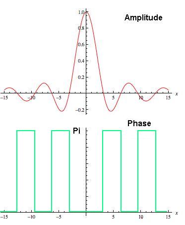

Till now everything is fine. But in order to get the slit image, i.e. performing an inverse Fourier transform, I need both amplitude and phase. Amplitude I have calculated above (~sinc), but what is a phase as a function of x (position on the screen)? Is it zero everywhere? I know that phase in this case will be zero at point where amplitude is positive and pi at points where amplitude is negave:
But how do I see the phase vs x from the diffraction pattern distribution?

Thanks guys! I already found the answer myself, which is: in the above case, Fourier transform is real (without imaginary part), so if I want to represent the amplitude on the screen I will write:
[tex]Y=Aasinc\left ( \pi ka \right )=Re^{i \phi}[/tex]

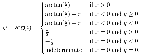

since the transform is real, Φ can be either zero or pi. To know if its zero or pi for a particular point I represent the amplitude as complex number Y=x+iy
So in this case:
[tex]x=Aasinc\left ( \pi ka \right ),y=0[/tex]
The phase is the argument of the complex number and is given by (from wiki):
So in my case y=0 always (no complex part), thus when my sinc function is positive (x positive) - phase is 0, and when it's negative (x negative) - phase is pi.
Thank you both anyway!
