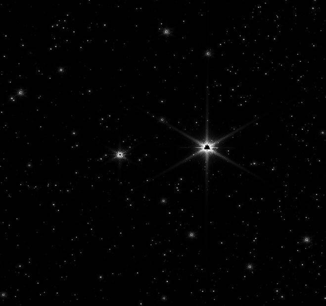

For clarity, we're talking about this star:
sophiecentaur said:
But why aren’t all (bright) star images like it?
They are (images from the same telescope optics, that is). You can even see it in the main subject star in the original image:
Ignore the dust rings for a moment, and concentrate on the central star. Its apparent shape is a hexagon, just like the other star (same size even). It's just that it's so much brighter that all the color detail is saturated (blown highlights), so it just looks like a white hexagon.
You might not see the hexagon shape in the other stars because they are relatively dimmer. With the dimmer stars, the outer 6 hexagonal components more easily blend into the background. But they're technically still there. You might be able to spot more if you look closely.
Much of what gets saturated and what doesn't, is not only dependent on the telescope's optics hardware (which may include the optical filters used) and exposure characteristics, but also on the image processing details, such as how the histogram was stretched before the final image shown.
Likes mfb and pinball1970

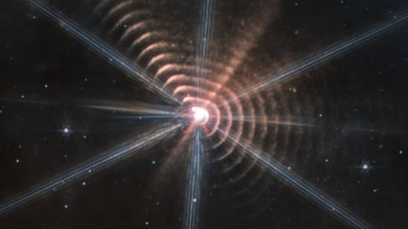

That's a help. I was talking about the 'dust rings'.
But aren't they the most remarkable feature?

collinsmark said:
That hexagonal artifacts (was well as any diffraction spikes) have a different cause than the actual dust rings.
A different cause, yes but that particular image has concentric red and green haloes. Do we see those on every start image (in addition to the six spikes from the three struts)? Anything that the telescope optics introduces would be common to many images but are those hexagonal halos common on more faint star images? This is my problem with your suggested explanation - I'd say a third effect has to be present when the sensor is operating way down its output range. (Ref that 'square nebula'
image. which is not explained by telescope diffraction.)
The bright spikes are only seen for bright stars that are saturating the image sensor at their centre; the spikes are very much fainter than that - levels of the same order as fainter stars whose spikes we do not see because they are too faint.
Likes pinball1970
image. which is not explained by telescope diffraction.)View attachment 315837
Yes, the artifacts are caused by the characteristics of the telescope's optics. The wavelength of light is also a factor, so the diffraction artifacts will manifest differently for different colors.
And the way the data is processed also impacts how easily the diffraction artifacts are noticeable. So different JWST images might show different artifacts, even though they share the same optics, just because they were processed differently.
Here's another image based on the same data (I believe, if I'm not mistaken), just processed differently, with a different stretch curve (and rotated and cropped differently).
Let me elaborate on one more thing, just for clarity.
Refer to the same image in my last post (shown again here):
For the moment, ignore the dust rings (shown in pink/orange in the image). Those are real, huge rings out in space, gigantic in size. I'm not talking about those in this post. I'm just discussing the diffraction artifacts for the rest of this post.
In the image, notice the obvious diffraction spikes of the the central star. Then there are a couple of other stars -- one to the left, and another to the lower right -- that show some diffraction artifacts, and the diffraction spikes are just barely visible. The rest of the stars don't seem to have any noticeable artifacts or spikes.
Based on this, one might be inclined to think that brighter stars produce bigger artifacts and bigger spikes in the telescope's optics. This is false. That's not how it works.
In truth, brighter stars produce brighter artifacts and brighter spikes in the telescope's optics. Brighter, yes, but not "bigger."
Yes, those two stars -- one to the left and the other to the lower right -- have the same sized artifacts and spikes as the central star. They're just so dim that you can't make them out, except for the brightest part of the artifacts.
The central star is bright enough such that the hexagonal artifact is so bright (due to the way the image was processed) it blows out the whole central region, obfuscating any detail. Again, don't try looking for a bigger hexagonal pattern from the central star. It's not bigger. The artifact is the same size as the others. It's just brighter.
And the rest of the stars? They have the artifacts and spikes too, but the stars are dim enough such that the artifacts and spikes are so dim they are not noticeable in the image.

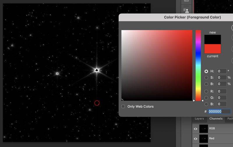

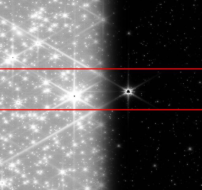

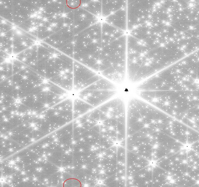

It depends how you processed the image.
The two images below are the same image both processed differently by myself from raw JWST sensor data:
You can see that in the second image, the diffraction spikes of the 2nd brightest star continues all the way to the top and bottom of the image frame.
Using the photoshop color sampler, I inspected the first image and the red circled area had an RGB value of 0,0,0.
Likes mfb and collinsmark

You can see that in the second image, the diffraction spikes of the 2nd brightest star continue all the way to the top and bottom of the image frame.
Indeed they do they have the same shape but even to a casual observer they have different widths are you really saying they are of the same dimensions? Cut and paste one in the other are they identical?
Also as I pointed out the FWHM of the stars is different. It all depends if the spikes is above the noise floor or not. Spikes from many stars in your stretched image don't reach the bottom.
Regards Andrew
Regards Andrew
The apparently brighter star has smaller diffraction spikes than the apparently dimmer one when I process the stars differently...
The star on the right is apparently brighter, but has shorter diffraction spikes than the apparently dimmer star on the left, because each half of the image was processed differently.

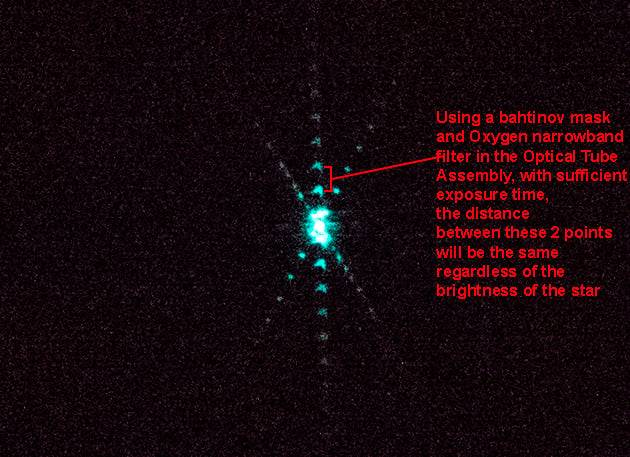

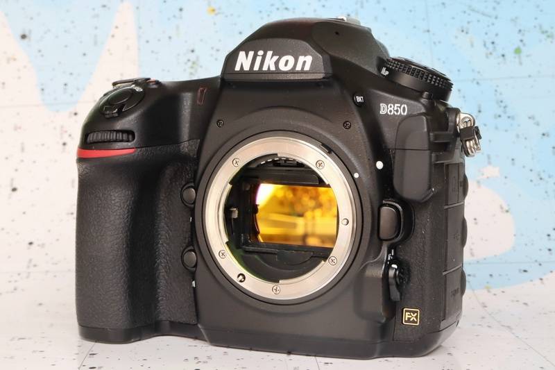

Another way to demonstrate the diffraction spikes are always the same shape… I take my Nikon D800 DSLR and insert a clip in narrowband Oiii filter in front of the sensor (which only allows one particular wavelength through to the sensor). Next I place a Bahtinov focusing mask in front of the objective lens of my telescope, which creates diffraction spikes.

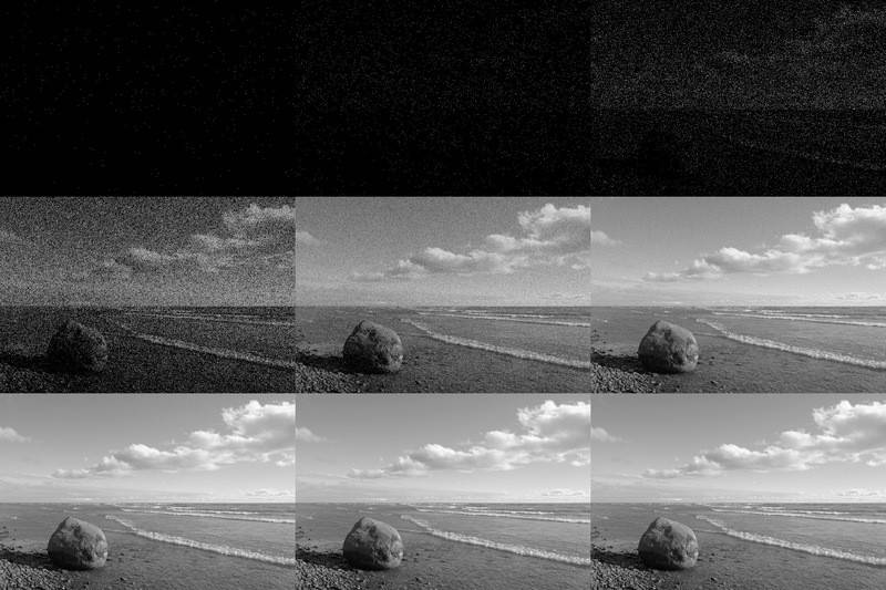

Yes, in principle that is what I am saying -- that is ideally, when the data is linear and we can ignore saturation and noise floors. Diffraction artifacts are in that sense without bound.
When you factor photon shot noise, an individual photon from a dim star should have an equal probability of ending up in a given “diffraction point” as an individual photon from a bright star. For example, a single photon from a dim star could end up striking the sensor farther from the star’s apparent position due to shot noise and diffraction than a single photon from a bright star.
https://en.m.wikipedia.org/wiki/Shot_noise
Photon noise simulation. Number of photons per pixel increases from left to right and from upper row to bottom row.
Likes sophiecentaur

  • #37
I decided to put a piece of window screen in front of my objective lens for a diffraction test…
I took a single 5 minute exposure of Polaris at 600mm focal f/9, 100iso with the window screen in front of the lens…
When I adjust the RAW conversion settings of half the 14 bit image (with the identical exposure / image data), the brighter Polaris diffraction pattern appears the same shape and size as the dimmer star in the upper right…
Likes Imager and collinsmark

  • #39
Not sure what you are trying to show other than by signal processing you can manipulate how an image looks.
Can you tell me how you measured the size of the images to be the same as your earlier claim was they are not finite but extend off the image?
Regards Andrew

One obvious reason for stacking is to identify cosmic rays. It's not difficult to identify because a subframe pixel affected by a cosmic ray will be a statistical outlier compared to the corresponding pixels in the other subframes.
And, as you mentioned, you can increase the signal to noise ratio above that of any single subframe by stacking multiple subframes. One can use the central limit theorem to show that (given a few assumptions about the noise being uncorrelated) the signal to noise ratio increases by a factor of \sqrt{N} over a single subframe, where N is the number of subframes stacked.
Stacking also increases the bit-depth in another way due to the probabilistic nature of photon arrival. Even if some sublte detail in a target is less than 1 ADU, it still affects the pixels in a probabilistic manner. For example if a star's diffraction spike over a particular pixel is only 1/5 of an ADU, you would expect 2 out of 10 subframes to have an additional ADU above the background for that pixel. And if you stack 10 subframes (averaging them), you can get that extra 0.2 ADU detail in the result. If you stack enough subframes you can gain resolutions better than even a single photon.
I don't know how much stacking is typically done in JWST images, but there's definitely some stacking done. There are gaps between the sensors within the sensor array, so there needs to be at least some stacking overlap for that at least. (See https://jwst-docs.stsci.edu/jwst-near-infrared-camera)
NIRCam modules field of view
For what it's worth, here's an image from the recent Pillars Of Creation redo, specifically showing the stacking overlap of the individual sensor cores. I downloaded this particular image from Mast, then I used PixInsight to apply a quick-and-dirty stretch to it (otherwise it would look nearly all black), resized it for PF, and saved it as a JPEG. This image was acquired using the F090W filter.
