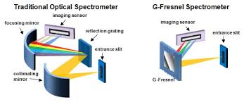

Real optical spectrometers vary a great deal in the components they use. A common one consists of two telescoped bolted to a turntable arrangement marked out in degrees-minutes-seconds. You put a diffraction grating (or a prism or whatever) in the center, point one telescope at the light, and turn the other to see the fringes. Crosshairs let you pinpoint the fringes quite well.
Below are two common setups.
