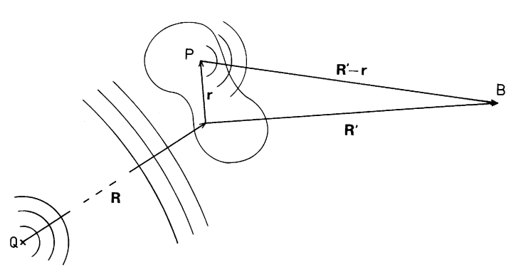

I am trying to understand diffraction on periodic structured in solid state physics.Q is the source of the spherical wave. R the vector to the object and R+r the vector to the scattering centre P, which gives us a another spherical wave.
All spherical waves are considered as plane waves due to the big distance between P,B and Q.
The magnitude at P can be described as: ##\Psi_P(t) = \Psi_0e^{i(\vec k (\vec R + \vec r)-\omega_0 t)}##
My questions:
1. The magnitude on point Q, which means ##\vec R + \vec r = 0##, is only depending on the time ##t## in ##e^{-i\omega_0 t}##. My book(Ibach, Lueth Festkörperphysik) says that it has a fixed phase anytime. According to wikipedia(https://en.wikipedia.org/wiki/Plane_wave#Complex_exponential_form) the phase ##\varphi## is included in ##\Psi_0##. **What does it mean to have a "fixed phase" especially at location Q?**
2. "You can only use this plane wave approach ##\Psi_B## for *a* emission process." my book says, but why is it so?
3. "In real emitters do atoms send many photons with uncorrelated phases. (Exception: lasers)" my book also says. Does that mean the phase of the different photos are independent to each other?

For a simplified case, the source Q can be from a pinhole, and it can be helpful if the scattering region is extended, e.g. a large crystal, that the source has the necessary coherence length, across the extent of the crystal, that the incident wave can be considered to have a constant/fixed phase. Having a monochromatic source, such as laser can be helpful in ensuring that this is the case. ## \\ ## The Bragg scattering is one of the simpler examples of scattering of crystals that makes use of diffraction theory. To get a Bragg maximum, two conditions are met: 1) The angle of incidence =angle of reflection off of a single plane 2) The path distance between the plane waves reflected off of parallel planes is an integer number of wavelengths. The first condition is the case of a zeroth order diffraction maximum for the individual scatterers from a single plane. The second condition results in interference maxima of integer order ## m ##. ## \\ ## There are treatments of Bragg scattering by a crystal that involve writing out the wavefunction and solving for the scattered intensity, sometimes by even writing out the Schrodinger equation. These can get quite complex, and the simplified analysis gets the main features of the scattering, without much mathematical complexity.

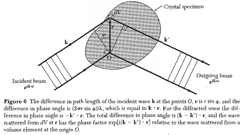

I saw a good picture in it, which also kinda confused me. I want to discuss it please:
E.g. I've never understood why it is ##e^{i\vec r \cdot \vec k}##. But why is ##\vec r## exactly the gap between the two atoms, where the incident wave will scatter?
I thought when you write a wave ##\vec r## can be arbitrary. Because ##\phi = vec r \cdot \vec k - \omega t## is the phase of the wave at time t and location ##\vec r##. So does that mean we fixed the location at a volume element dV here?
Usually, at least when you first start out in doing an analysis with waves, the origin is taken to be the place where the wave originates from. Then the phase for a wave with wave vector ## \vec{k} ## is ## \phi=\vec{k} \cdot \vec{r} ##. It turns out that the origin can be put at some other arbitrary location, and it does not affect the phase difference that is calculated between the two sets of rays that get scattered and change direction from ## \vec{k} ## to ## \vec{k}' ##. One gets scatterered at ## \vec{X} ## and the other at ## \vec{Y} ## in the crystal. If ## \vec{r}=\vec{Y}-\vec{X} ##, the phase difference in the two sets of rays when viewed in the far field in the direction of ## \vec{k}' ## will be ## \phi=(\vec{k}-\vec{k}') \cdot \vec{r} ##. To compute this in full detail, the two incident paths pick up phase differences ## \phi=\vec{k} \cdot \vec{Y} -\vec{k} \cdot \vec{X}=\vec{k} \cdot \vec{r} ##, with a similar expression with ## \vec{k}' ## for the emerging beam. The correct sign is a minus between ## \vec{k} ## and ## \vec{k}' ## for the complete phase difference. The reason for the minus sign is not so obvious, but if ## \vec{k}=\vec{k}' ##, the path and phase difference must necessarily be zero. In the diagram, the incident ## \vec{k} ## points along ##\vec{r} ## , and the way Kittel shows it in the diagram, ## \vec{k}' ## points opposite ## \vec{r} ##. A similar type of sign problem always becomes an extra detail when treating a diffraction grating problem, with the phase of the transmitted beam, (for a transmission type grating), getting a minus sign for the other quadrant, and similarly for a reflection type diffraction grating for the reflected beam. ## \\ ## Note that for non-normal angles of incidence (## \theta_i \neq 0 ##), the complete equation for the position ## \theta_r ## of the diffraction primary maxima location is ## m \lambda=d(\sin(\theta_i) \pm \sin(\theta_r)) ##, where the sign of the ## \pm ## is determined by what direction is defined to be a positive angle for ## \theta_r ##.

The problem is most easily worked backwards for the emerging part. If you go in the far field at the angle where ## \vec{k}' ## aims at, let this be the origin of the second part of the problem, and you basically are repeating what you did in the first part of the problem. The result is you get ## \phi=(\vec{k} \pm \vec{k}') \cdot \vec{r} ##, where I leave it to you to determine the sign of ## \pm ##. Please see also the last sentence I just added to post 10. ## \\ ## Edit: One problem emerges in this analysis, and that is that we are using two different origins in working the problem. It is important to see that the origin can be moved to another common location (e.g. somewhere outside of the crystal), and each of the results that we got for the two parts still remain valid. ## \\ ## And note: These scatterers scatter the light in all directions. We are selecting a specific direction ## \vec{k}' ## and seeing how much light gets scattered in that direction. There will be some directions ## \vec{k}' ## for which we find that we get constructive interference from the sum of all the scattering amplitudes of the atoms of the crystal, e.g. where the Bragg peaks occur.

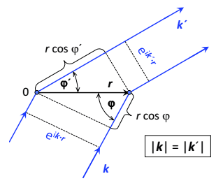

I also found another German book "Festkörperphysik" by Gross and Marx. There I found a picture for which explains the so-called Laue Equations:
You described this earlier as ##m\lambda = d(sin(\theta_i)\pm sin(\theta_r))## in #10. But in my book it says: ##m\lambda = |\vec r|(cos \varphi ' - cos \varphi)##
1. Why did you use sin()? Did you maybe use different angles?
2. The right term of the equation is apparently the path difference. But why? I don't see how this could be the path difference between the incident plane wave and the reflected plane wave. Because e.g. ##r\cdot cos(\varphi)## is the path difference between the incident wave at 0 and r. And same goes for the reflected wave. ##r\cdot cos \varphi '## is just the path difference between 0 and location r.
So why would the difference of these path differences the path difference in general? Or why is this constructive interference?

The equation ## m \lambda=d \sin(\theta) ## is used frequently enough, that I should get you a "link" with a picture. Here, I found one: https://en.wikipedia.org/wiki/Fraunhofer_diffraction#/media/File:Double_slit.svg Having done a lot of work with diffraction grating spectrometers, I have seen this equation countless times. I haven't done the solid state case of scattering by a crystal nearly as often. Your post was the most in-depth check of those equations to date that I have done. ## \\ ## The path distance comes in two parts: First the two incident rays a distance ## d ## apart have a path distance difference of ## d \sin(\theta_i ) ##. Then the two diffracted parallel rays have a path difference of ## d \sin(\theta_r) ##, but this second part can come with a minus sign, depending upon which direction is chosen as a positive ## \theta_r ##. ## \\ ## This far-field (Fraunhofer) two-slit and multi-slit case ## \Delta=d(\sin(\theta_i) \pm \sin(\theta_r)) ## is actually much simpler to compute than the solid state vector calculation. You simply assume the two incident parallel rays originate from the same point, and calculate the difference in distance of the two rays to the two slits that are spaced a distance ## d ## apart. The scattered rays are observed at the same location in the far field, and it is really the identical calculation as the incident rays, to compute the path distance difference to a faraway point in the far field. The calculation is done in one plane, and you don't need to work with 3 dimensions. And, yes, the angle in this Fraunhofer rwo-slit diffraction case is measured from the perpendicular bisector of the line connecting the two slits, instead of employing a vector ## \vec{d} ## that points from one slit to the next. In the case of a diffraction grating, the angle is measured from the normal to the grating.

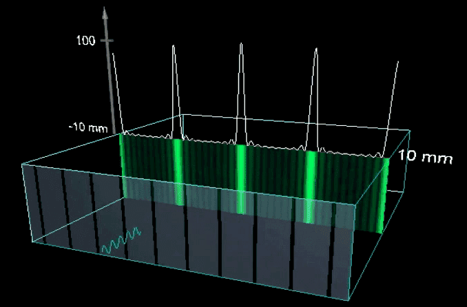

2. I want to discuss the diffraction on a simple optical grate with x slits please, because it is very similar to the atomic grate in a crystal. The intensity looks like this, when we have a certain number of slits and a ray of light with wavelength according to the Bragg equation falls on the grate:
So the different five highest peaks are called m-th order. And when ##\theta_i = \theta_r## we have the strongest constructive interference, which gives us the highest five peaks we see in this picture. Can you actual say that?
For the diffraction grating, there are two types: A transmission grating and a reflection grating. The equations are the same for both. Let's just consider the transmission grating. ( For the reflection grating, the narrow slits are replaced by "Huygens mirrors" that scatter the light in all directions, effectively doing the same thing as narrow slit Huygens sources that scatter the light in all directions). For these Huygens sources, single slit diffraction applies, so that the light can be assumed to scatter in a fairly wide pattern. If the slits are finite in size, the pattern will narrow somewhat. The result for finite slit width is an intensity pattern that is a product of the interference factor multiplied by a diffraction pattern factor for a single slit. See http://www.physics.louisville.edu/cldavis/phys299/notes/lo_msgratings.html ## \\ ## In the case of a reflective type grating, (as well as for a transmission type grating), this will mean the pattern is highest for the central ## m=0 ## maximum, unless a blazed grating is used that makes a specular reflection and makes the peak intensity occur at some other angle, e.g. at ## m=1 ## or thereabouts. See https://en.wikipedia.org/wiki/Blazed_grating (The central ## m=0 ## maximum, in the case of the reflection grating is the specular reflection. For the transmission grating, the central ## m=0 ## maximum is centered in the straight-line path through the grating). ## \\ ## To comment on your first question about the Bragg scattering=it is always somewhat clumsy in needing to figure out where the angle is measured from: I have done diffraction gratings most often where they use ## m \lambda=d \sin(\theta) ##. Every time I pick up a solid state physics book such as Kittel or Ashcroft-Mermin to read about Bragg scattering, I always need to reconstruct their coordinate system to get the ## m \lambda=2 d \cos(\theta) ## result.

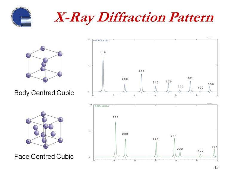

I see so the x-ray diffraction pattern must be the same for 3D crystals:
Let's consider the peak (110) at the bcc crystal above. (110) also called miller indices and describes a simple plane in the crystal. (110) has many planes parallel to each other. So that parallel planes are like a diffraction grate.
But why does this only represent one peak at 110? Is this the "main peak" or how can you interpret this diffraction pattern? For multiple-slits it's easier somehow.
In the case of x-ray diffraction Bragg peaks off of a crystal, two things occur: We have ## \theta_i=\theta_r ## for a single plane, and ## m \lambda=2 d \cos(\theta) ## between parallel planes. In general, this means that there could be peaks for multiple ## m ##, at different locations. The largest value of ## \cos(\theta) ## is ## 1 ##, so that if the length of the x-rays is just slightly less than ## 2d ##, there will only be an ## m=1 ##. ## \\ ## A careful study of the way the light reflects off of parallel planes shows that the scattered light off of an individual plane is taking on the geometry of the transmission type grating rather than a reflection grating. For the transmission grating, the ## m=0 ## is the case of light going in the forward direction. The peak that occurs in this direction is ignored in these scattering experiments=in general there is always the main beam that is disregarded. Thereby, ## m=0 ## is ignored, and if ## \lambda ## is sufficiently large, the only peak may be ## m=1 ##. For shorter wavelength x-rays, there should also be ## m=2 ## and ## m=3 ##, etc. ## \\ ## Alternatively, instead of viewing the parallel planes like the slits of a diffraction grating, it can be viewed as parallel planes of a Fabry-Perot type geometry. (Fabry-Perot effect is the interference effect(s) that occurs between parallel planes). In that case ## \Delta=2 d \cos(\theta) ##. Once again, the coordinate system always needs a careful review to see where ## \theta ## is being measured from. ## \\ ## Just an additional item on the angle: There are textbooks and "links" that reference the angle of incidence from the planes of the crystal rather than from the normal to these planes. They then write Bragg's law as ## m \lambda=2 d \sin(\theta) ##. It always requires carefully drawing the diagram to get the angles right.
