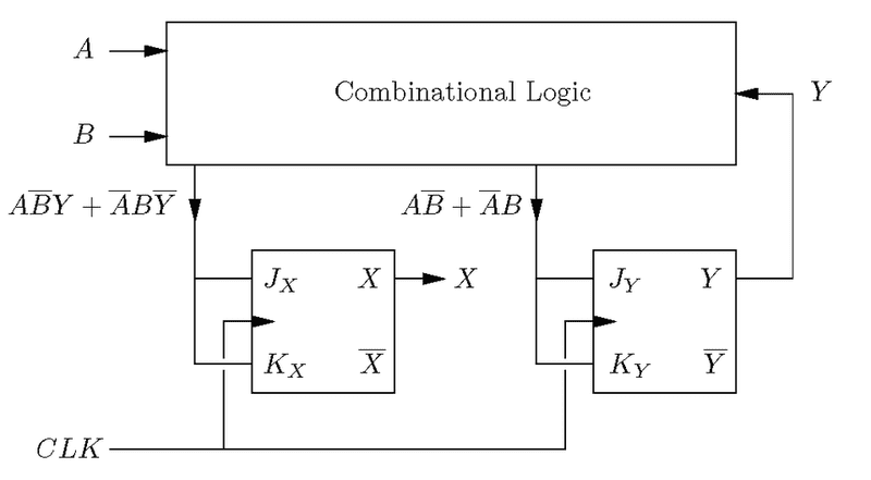

(a) How many states does this system have?
(b) How many rows will there be in a state transition table?
(c) Provide the state transition table.
(d) Draw a state diagram of the system.
(e) Describe what the circuit does in words.
a) I think there are two flip flops (or are they switches?), so that means that there are four states: 00, 01, 10, and 11.
b) I think the state transition table will have 8 rows. These numbers will be at the beginning of each row:
000
001
010
011
100
101
110
111
