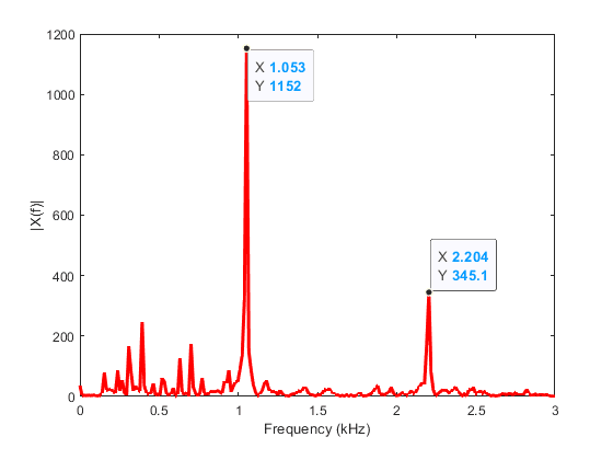

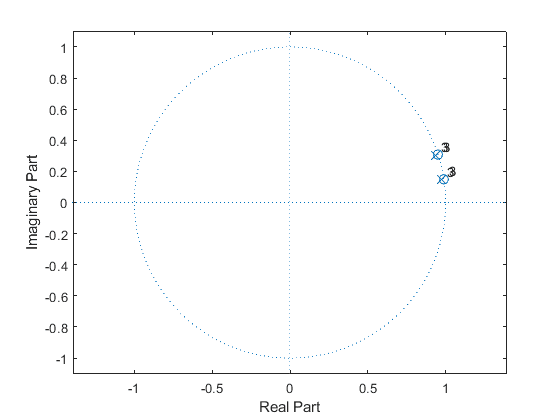

As far as where zeros can go: It depends. It depends what kind of filter you're making and what the requirements are. To my recollection for real filters you'll need to use conjugate pairs if that's what you're asking. If you see it on the top half of the polar plot, then you'll need the conjugate pair on the bottom half mirroring the top. Here's an example pole zero plot for a filter I made in the classroom. Filter below I needed something narrowband and so my poles and zeros are very close to each other. Putting zeroes in the center didn't do anything for me (admittedly not sure if there's a practical application for that).
This one was a band reject filter. The professor gave us a sound file where he injected two random tones in there totally degrading the original sound. In other words I wanted to remove these two large peaks (1053 Hz and 2204 Hz) and keep the other things that were from the original sound file.

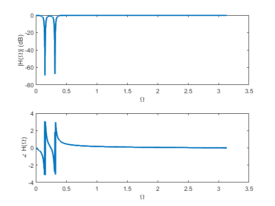

Discrete time domain
To do this I needed the zeroes to be closer to the outside edge of the unit circle than the poles. You can see very clearly on this polar plot that there are 4 poles and 4 zeros. The pole would act like a low-pass filter, then the zero would bump it back up like a high-pass filter, which gave me each notch. I needed two sets of these (one for each frequency tone I wanted to remove) and their conjugates. The angle was related to the frequency, and so closer to 0 Hz would be close to 0, then maximum frequency would be up to ##\pi##. This was for a sound file I think maximum frequency was around 22 KHz. If I wanted to filter something at like 20 kHz for example then you could expect the X and 0's to be on the other (left) side of the plot.

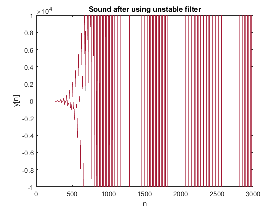

If the poles went outside the circle, then it was unstable and results would oscillate.
When I look at the results in the frequency domain alone everything looks great and the professor might even be happy, but results in time domain if the poles went outside the circle. I used ##n## because it was discrete.

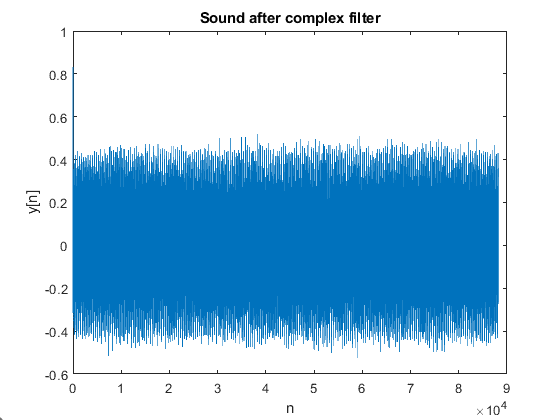

If I don't do the conjugate pair like below, then I got totally different results. Computer didn't know what to do with the imaginary component and just omitted it.
DO NOT DO THIS without conjugate pair like below

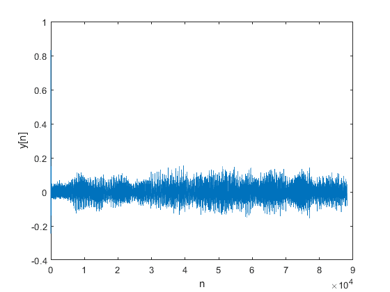

What I was expecting in the time domain
What I got using a complex filter that did not use conjugate pairs
