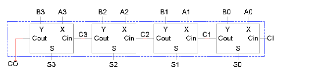

Build a circuit that either adds or multiplies two 4-bit numbers based on a control input C(C is 1 add, C is zero multiply). Numbers are positive and negative so use two's complement. You can use muxes, Full Adder Circuits, and logic gates
Multiplier circuit=
Adder Circuit:
So, I have built both the Full Adder(for the addition part) and the multiplier. However, I don't know how to use the muxes to get the input switching if control is 0 and 1. Since the mux only has one output, I don't understand how to connect the two circuits together. Any help is much appreciated!
The mux output is the final result - one bit of the addition or multiplication depending on the state of C. Where do you expect more outputs? You'll need one mux per bit (or a mux block that can handle multiple bits in parallel).

The multiplexer looks like every other multiplexer - for each bit, choose either input A or input B as output, depending on a control bit. Do that for all 4 bits.

should we use 4:1 mux or 2:1 mux ?
Addition and multiplication are 2 operations. What else do you want to put into the MUX?

only addition and multiplication.
