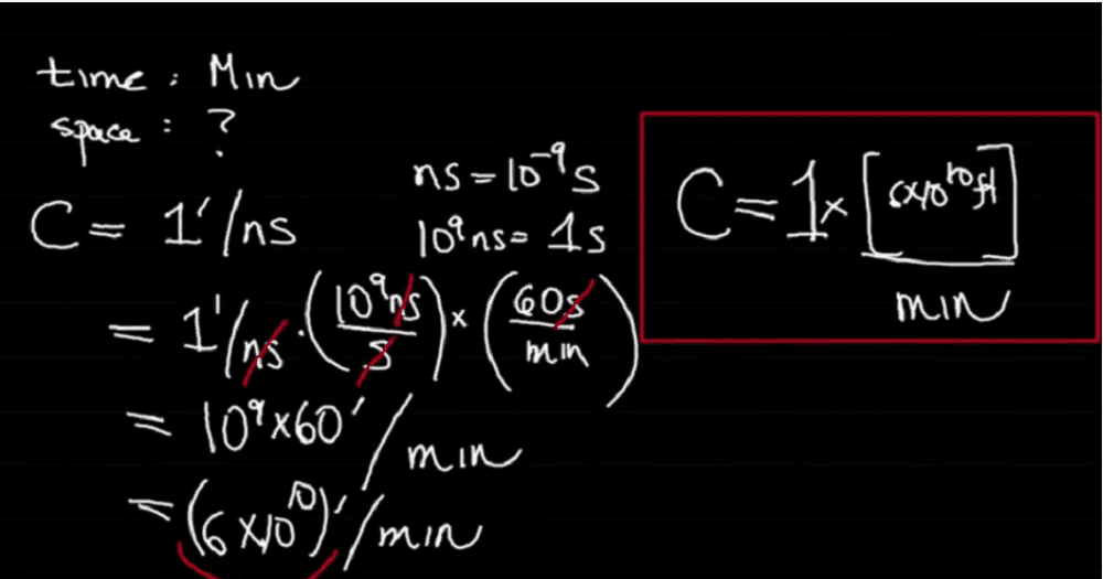

If someone is using the minute as their unit of time, what unit should they choose for length so the speed of light will be one in those units?
Dimensional Analysis
time = x(min)
distance = 1(y)
y = unknown unitsI think the answer should be 1(y)/ Min. This is not correct becase 1(y) is unknown. Any help?
I have the answer but am confused
How far does light travel in one minute?
A light minute.

Is a light minute a unit of distance?
Yes
gtguhoij said:
Yes
And if you measure distance in light minutes and time in minutes, what is the numerical value of the speed of light in those units?
Likes Steve4Physics
gtguhoij said:
1 light minute.
That has the wrong dimensions for speed. Speed has dimensions of ##LT^{-1}##.
Let‘s try a different approach. You are trying to convert to a new unit of velocity (nuv) which has magnitude 1. It is given that the new unit of time (nut) is 1 minute. You are trying to figure out the new unit of distance (nud). In these units, velocity is measured in nud’s per minute. The question is how many ft are in a nud so that when you convert the speed of light from ft/ns to nud’s/min you get 1 nud/min.

I'm lost for words. I have no idea what you are trying to do: ##c = 1## light-minute per minute, by definition.
This might help...
You do not need to use c = 186,000 miles/second.
An apostrophe is the symbol for 1 foot.
It appears you are told that c = 1’/ns. This means c = 1ft/ns.
So light moves 1 foot each nanosecond (approximately true in a vacuum).
How far (in feet) does light travel in 1 minute?
This distance is the size of the required unit (which you call ‘y’), because light travels a distance ‘y’ in 1 minute. So speed = 1 y/min.
The question simply wants the value of y expressed in feet.

I get what to do now to get the correct answer. Is the math correct in post #11? Even though it doesn't answer the question.
No. One light minute divided by the speed of light equals 1 minute. There’s a typo in the velocity equation (1 too many zeros). In the time equation, the units of velocity in the denominator are wrong and there are issues with your calculated value of a light minute (it looks like you are mixing different time units, seconds and minutes).
