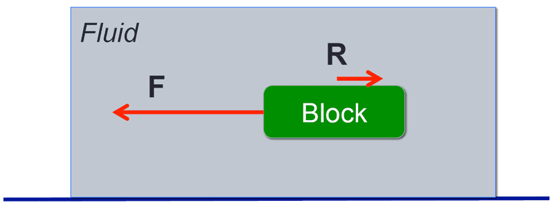

A block of mass ##m = 1.00 kg## is being dragged through some viscous fluid by
an external force ##F = 10.0 N##. The resistive force can be written as ##R = -bv##,
where ##v## is the speed and ##b = 4.00 kg/s## is a phenomenological constant. You
may ignore gravity (we imagine that the block is floating inside the fluid). The
following integrals may come in handy:
$$\int \frac 1 { z } dz = ln(z), \int e^{-at} dt = \frac 1 a e^{-at}$$
a) Using the three physical quantities provided, use dimensional analysis to
find the terminal velocity of the motion ##v_T## and the characteristic time ##τ## .
b) Assuming that the block starts from rest, find ##v(t)##.
c) Find the distance traveled as a function of time ##x(t)##.
Some of the work done by the force F on the system becomes internal energy,
some becomes kinetic energy.
d) How much internal energy has been generated by the time the
block reaches half the terminal velocity, ##v(t) = v_T/2##? How big a fraction of
the total work is that?
##m=M##
##F=\frac {ML} {T^2}##
##R=-\frac {LM} {T^2}##
##v_T = \frac L T = m^aF^bR^c##
##M=0=a+b+c##
##L=1=b+c##
##T=-1=-2b-2c##
This doesn't work. So I'm kinda stuck.
I also don't know what is meant by "characteristic time".
You need to separate ##R## into ##b## which has some dimensions (what?) and ##v## which has dimensions ##LT^{-1}##. What kind of equation do you get then?
The exponential ##e^{-at}## can be rewritten as ##e^{-t/\tau}## where ##\tau = 1/a## is the time constant or characteristic time. It is the time required for the exponential to drop to ##1/e## of its initial value.
On edit: To elaborate a bit. Since the magnitude of ##R## is ##bv##, when terminal velocity is reached, ##R## reaches its terminal value ##R_T=bv_T##. You can't have dimensions of ##v_T## on both sides of the equation.
On second edit: Part (d) says "How much internal energy has been generated by the time the block reaches half the terminal velocity, ##v(t)=v_T=2##?" Shouldn't it be "How much internal energy has been generated by the time the block reaches half the terminal velocity, ##v(t)=v_T/2##?"
Likes lichenguy

##b## has dimensions ##MT^{-1}## and together with ##v## i got the ##R=-\frac {LM} {T^2}## above. Yeah, i already did that. I guess i don't understand "You can't have dimensions of ##v_T## on both sides of the equation.".

R is a variable within the process, i.e. a function of time. It cannot feature in the expression for terminal velocity. Find the more fundamental parameter. (Hint: to avoid confusion, you should also change your choice of unknowns for the powers.)
Likes lichenguy
So, ##R## is not an independent variable and that is why we can't use it?
Using ##b## instead yields: ##v_T=F/b##
And solving for dimension ##T## gives: ##m/b##
But, what does this ##T## mean here? The time constant means dropping the initial value to ##1/e## percent or increasing the value to ##1-1/e## percent. Is that happening here?

That's not quite it. The terminal velocity depends on certain parameters that describe the set-up. R is not one of those parameters. It is a function of time during the process, so its value changes with time. F, m and b are the constants that determine the behaviour.
lichenguy said:
what does this T mean here?
It tells you how the system behaves as you vary the parameters. If you increase m, keeping b constant, then the process slows down, i.e. it takes longer to reach a given fraction of its terminal velocity. If you were to plot the velocity as a fraction of terminal velocity against time, the time axis is stretched, but the graph otherwise stays the same. Conversely, increasing b for the same m speeds up the process. Changing F has no effect.
