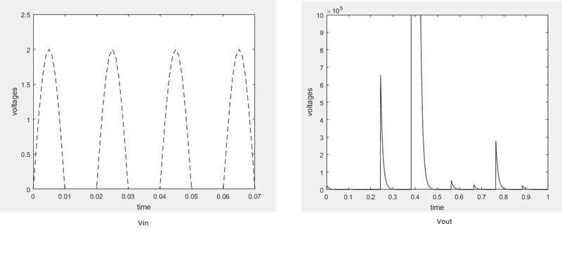

The problem I've had with this is that when I write a MATLAB program to solve it, and display it as a graph, it definitely doesn't seem correct. For some reason, the voltages are incredibly small, i.e. 2x10^-16.

Check your timestep size. How does it compare to the period of the input waveform? What's a reasonable total time to cover, say, two full periods?
I've now tidied it up, but the graph doesn't look promising. The Vin graph is fine, but the Vout isn't good at all, Vout does get quite large.

Here are the graphs:
Vin should be between + and - 2 Volts, so you'll want to adjust the y-axis for its plot.
I think that your dt should be even smaller to begin with. Try something like a hundred "samples" per cycle of the input.
I see that your output voltage scale looks rather large. You'll need to find out how that happened. Try printing out the terms of the equation for a few iterations and see where they're headed.
Thank you very much, it is working perfectly now. I manually adjusted the scale for Vout since it was very much of the graph. Once again, thank you for your help.
