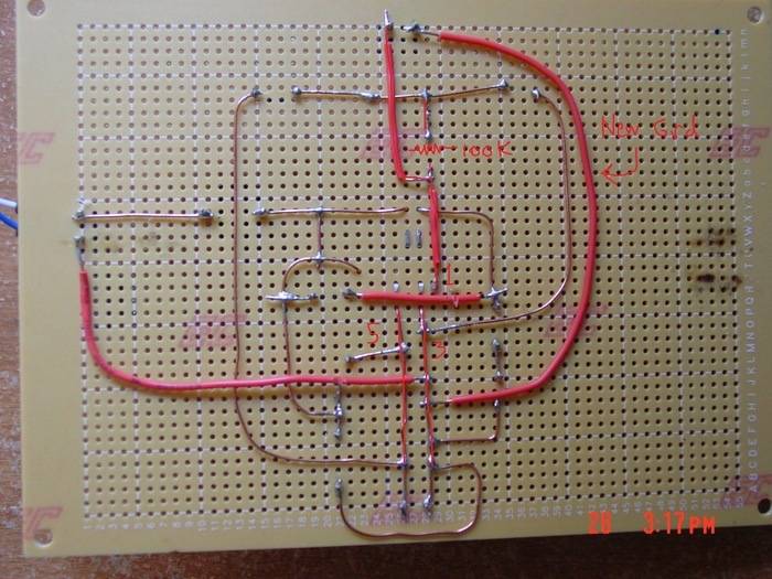

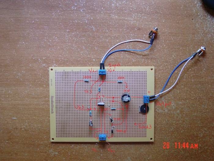

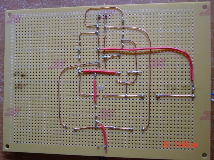

Don't mind the missing ground connection. I took it off for diagnostic purposes. The amp isn't working either way. Assume it's there.
The dots represent connections. The arrows indicate a circuit running under another area. For instance, ---> component <--- indicates that there's a wire under the component but not connected to it.
I've used the Typical Application diagram as my basis. I'm feeding it 18 volts (verified) from a simple AC-to-DC rectifier I made. I'm using pin 3 (Vs-) as my ground in all cases.
Thanks.
Check you input circuitry again closely. The 100K resistors are not supposed to be connected directly to the input.
Thanks EMI.
I made the resistor a 2nd path, which I think is what we were aiming for. Added back the ground connection for input. Still no music but I do hear the soft popping when I connect the headphones.

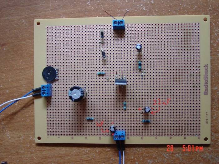

Where is your 1uf input capacitor?
Thanks EMI; 2nd set of eyes and all that.

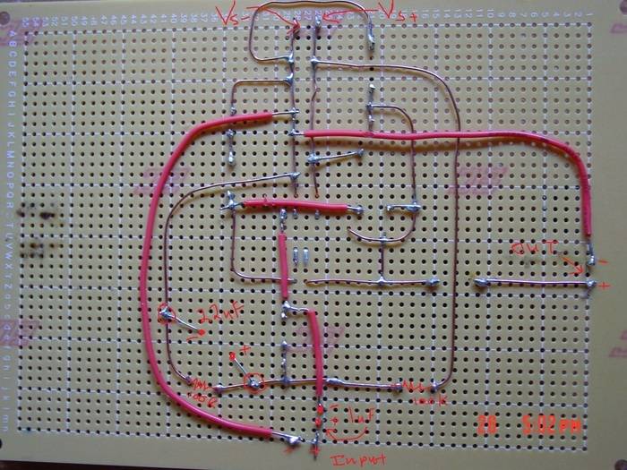

Ok so I added the 1uF and the 22uF (bottom left of circuit diagram).
I checked the output twice, after adding the 1uF and then after the 22uF. The sound actually got worse after adding the larger capacitor. Having said that there was an audio signal initially albeit buried under static and popping. Currently it's unlistenable.
There's a couple decoupling capacitors in the diagram just after the Vs+ but before the first 100k resistor. I don't have those. And there's a circuit from pin 4 (output) to ground before the 2000 uF capacitor. Don't have that either. Finally, I'm using a 1000 uF in place of the 2000 uF since I just don't have one right now. That's full disclosure.
Add the decoupling caps.
Sometimes it's hard to get amps like this to work unless proper layout guidance is observed. Leaving decoupling caps off may aggravate the situation.
You can also try lowering the gain (reducing resistor between pins 2 and 4).
After adding the decoupling capacitors for the Vs+ it works. Weird thing is that the voltage between pins 5 and 3 is like 5.83 when I have the potentiometer fully open. With no current being pulled the voltage is like 17ish.
