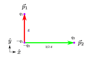

I am given this picture
and I know that |q1|=2nC, |q2|=5nC, d=1mm
I need to first find the total dipole moment of the system. Then I need to find an equation that represents the electric potential due to this net dipole moment for all (everywhere)
p=qd
I saw a formula which was p=qd (vectors)
so I thought I would separate it into two different dipole moments, one for q1 and one for q2, and then add them together. For p1 I got 2x10^-12 in the y direction, and for p2 I got 5x10^-12 in the x direction. Would this be correct?
Also, would I be using this formula for the potential?
V = kpcosθ/r^2
What happened to the 3/2?
What is the direction of a dipole moment vector?
Ok, so 7.5x10^-12 in the x direction. And for the potential?

Assuming a certain definition of θ, yes.

I'm not quite sure what θ would be in this case

Maybe better to put the answer in vector form. If ##\vec p## is the dipole at the origin and ##\vec r## is a point in space, what is the potential at ##\vec r##?

I don't know what the formula for potential would be,except I had V=kpcosθ/r^2 in my notes but I don't know when to use it

That makes for not terribly useful notes!
It arises from the dot product of the two vectors.

So the dot product of p and r?

Yes. Can you write the whole expression?

I'm not really sure what you want, I assume r will have an x and y component, so r cosθ and r sinθ
so then
(7.5x10^-12)(rcosθ)+(2x10^-12)(rsinθ)
Sorry I don't really have any idea what I am doing because I have no notes/ teaching on this stuff.

What will the r hat be ?

Putting a hat on a vector is a standard notation meaning the unit vector in that direction. So for any vector ##\vec x##, ##\hat x=\frac{\vec x}{|\vec x|}##

Here they don't specify a length or direction for r, it just says "everywhere"

The potential is necessarily a function of position. You cannot say what it is "everywhere" without involving a variable to specify position.
