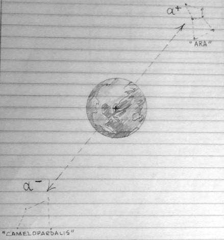

Hey folks,
Can you help me understand exactly what is meant by the term "dipole pattern" in this context? Is it simply the fact that one direction measured + and the opposite direction measured - ? As in this illustration:
This is throwing me for a loop because dipole field strength (at least in ham radio) goes up as you are at 90 degrees to the actual axis of the dipole, not 180. (180 would represent a + to + or - to - ). I normally think of 90 degrees as being the + to - range of field strength for a radio dipole. And yet the Alpha measurements were showing a 180 degree + to - strength change? Any help anyone can offer is much appreciated! (I am probably I am over-complicating it!).
mikenw said:
Hey folks,
I think so. As in, they claimed the fine structure constant was slightly higher in one direction compared to the opposite direction. This is averaged over observations in many different directions.
Likes mikenw
You get the 90° if you take the magnitude. In radio transmission, you are interested in intensity only, which depends on amplitude squared. Look at the "+-" direction and you see something (if there is a dipole dependence, which is highly questionable), rotate by 90° and you see nothing.
