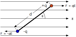

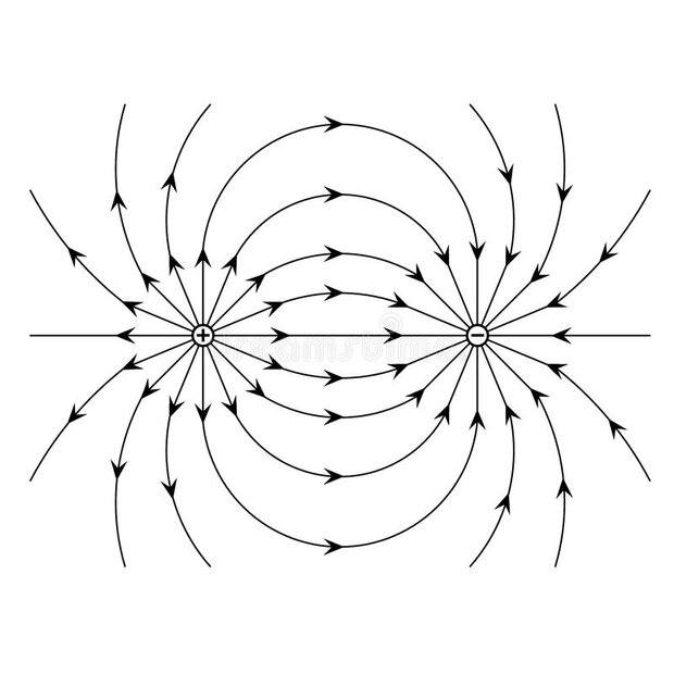

When an electric dipole is placed in a uniform electric field of ##\vec E## as shown in second diagram below, then does the non-uniform electric field due to the dipole superimpose with the uniform electric field to create a net non-uniform electric field?
##\vec E_{net} = \vec E_1 + \vec E_2 + \vec E_3 + ...##, which is the principle of superimposition of electric fields at a point
My understanding is that the uniform electric field ##\vec E## cannot be the net electric field since the dipole creates its own electric field as shown in first diagram below, which must superimpose with the uniform electric field. So, yes, the uniform electric field ##\vec E## around the dipole gets altered to a non-uniform electric field due to the principle of superimposition of electric fields.
Yet, and this gets confusing, when we are determining torque on the dipole as in second diagram, we are calculating the force on each charge as if only the uniform electric ##\vec E## exists without any modification/superimposition. So according to me, the force on each charge should not be just ##qE##, but the vector sum of the forces due to the other charge and ##qE##.
Yes, the total field is not the same due to the presence of the dipole. However, in the second case it is usually assumed that the two charges are held at a fixed distance (##d## in the figure), and thus you want to consider only the effect of the external field on the dipole (often only as a function of the angle ##\theta##).

vcsharp2003 said:
Why should the force due to the other charge be ignored? If it's ignored then there needs to be a valid reason for it.
The 2 charges in a dipole are at a fixed separation. For an isolated stationary dipole, the attraction between the 2 charges must balanced by some additional (repulsive) force. If this were not the case, then (from a classical viewpoint at least) the 2 charges would accelerate towards each other.
So, for an isolated dipole, the resultant force on each charge is zero.
The additional force on each charge, from superimposing an external electric field, is therefore the new resultant force on each charge.
So the force from the external electric field can be treated as the only force on each charge.

That makes sense, but then the question comes up that what could be this extra repulsive force.
Also, I am thinking that even if we consider the attractive force on each charge, it will not contribute to any torque about a point on dipole's axis since this attractive force is always passing through such a point. So, for torque calculations we can ignore the attractive force. Does this seem like another reason for attractive force not being considered for torque calculations?
Yes.
Likes Steve4Physics and vcsharp2003
Yes. That's a good reason. The internal (attractive and repulsive) forces will not contribute to torque arising from external fields. (This is generally true - not just for dipoles).
