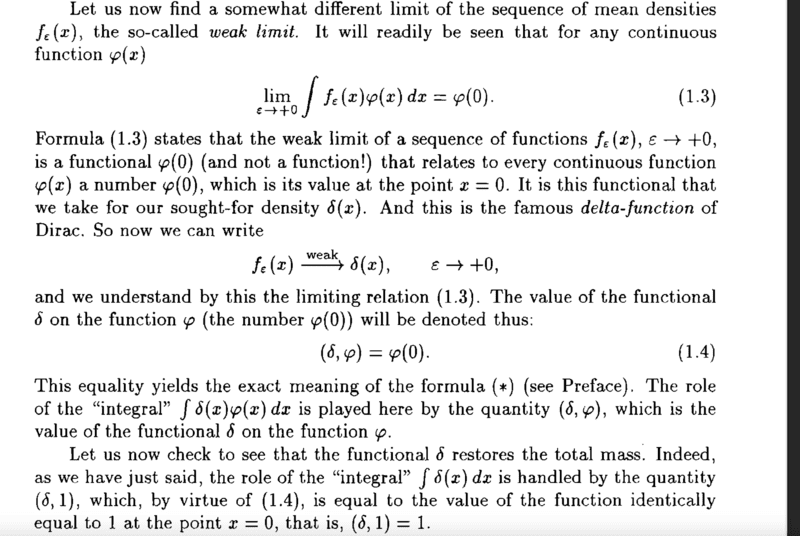

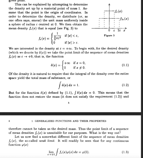

Hi guys. I've somehow ended up in a rabbit hole because I wanted to learn more about this and now, I'm at a big confusing state. I'd appreciate so much if you could answer these below questions one by one.
I learned that dirac delta is a distribution(i.e mapping) from function to real numbers. This was all clear until I looked into the "point mass" example and density.
Imagine, there's a point mass of 1kg at the origin. For sure, if you wanna figure out the density(forget dirac for now), you get infinity at ##x=0## and 0 everywhere else. Though, if you integrate this function, you don't get mass of it which is 1. So we got a problem.
So we call dirac distribution to be mapping whose input is ##\varphi(x)## and value is ##\lim_{\varepsilon \to 0}\int f_\epsilon (x)\varphi(x) dx## which ends up to be ##\varphi(0)##.
Attaching the image from the book.
Question 1: The book proceeds to mention the following: "It is this functional that we take for our sought-for density ##\delta(x)##. And this is the famous delta-function of Dirac." - If ##\delta## is a distribution, does the author(when he mentions ##\delta(x)## mean that argument (which is ##x##) is assumed to be a function ?
Question 2: Also, how does ##\lim_{\varepsilon \to 0}\int f_\epsilon (x)\varphi(x) dx## really represent the density ? Where does this show that at ##x=0##, the density is infinite ? I'm saying all this because author says: ""It is this functional that we take for our sought-for density ##\delta(x)##""
Question 3: The author of the book restores the mass by inputting ##\varphi(x) = 1## to the distribution which for sure, gives back 1 again, but why does he input 1 ? It should have a logical justification why such ##\varphi(x) = 1## is inserted - I mean, justification for our mass density situation/scenario.

Are you interested in hyperreals, or do you want to stick only with real numbers? If you want to stick purely with real numbers then this statement is incoherent:
gionole said:
you get infinity at x=0 and 0 everywhere else
True, but I'm trying to make sense of the author's analysis. I'm also attaching the "before explanation".
Could you check my 3 questions after you take a look at what author is saying ?
Sorry, but that didn’t answer the question I asked you above. I cannot proceed without you answering that question because it dramatically changes the answer.
Well, density when you got a point mass is definitely infinite. So let's proceed with hyperreals(whatever includes infinity).
Likes Dale
So in the hyperreals the discussion is not nearly so complicated. First, we define the hyperreal function: $$\delta(x) =
\begin{cases}
1/\epsilon & |x|\leq \epsilon/2 \\
0 & \text{otherwise}
\end{cases}$$ where ##\epsilon## is any positive infinitesimal hyperreal number. There is no need to call this a distribution rather than a function, it is a legitimate function taking any hyperreal argument ##x## and returning a hyperreal number, either ##0## or the infinite hyperreal number ##1/\epsilon##. There is also no need to take limits as ##\epsilon## approaches 0. Any infinitesimal ##\epsilon## is already small enough. This function has the desired properties, for any non-zero real ##x## its value is 0, its value is infinite at ##x=0##, and its integral (over any real region containing 0) is 1.
With that then instead of defining the mass as a point mass, we define it as an infinitesimal sphere of uniform density with a total mass ##m##. From the perspective of the real numbers that is a point mass, but when we zoom in infinitesimally it is a small sphere. We can then define the density straightforwardly as $$\rho(r)=m\frac{6}{\pi \epsilon^2} \delta(r)$$ Note that the density is infinite inside ##r\leq \epsilon/2## and zero outside. When we integrate the density we get $$\int_0^\infty \rho(r) \ 4 \pi r^2 \ dr = m$$
gionole said:
Question 1: The book proceeds to mention the following: "It is this functional that we take for our sought-for density δ(x). And this is the famous delta-function of Dirac." - If δ is a distribution, does the author(when he mentions δ(x) mean that argument (which is x) is assumed to be a function ?
There is no need to make it a functional. It is a standard hyperreal function.
gionole said:
Question 2: Also, how does limε→0∫fϵ(x)φ(x)dx really represent the density ? Where does this show that at x=0, the density is infinite ? I'm saying all this because author says: ""It is this functional that we take for our sought-for density δ(x)""
There is no need to take the limits at all. We can simply write the density explicitly in terms of our hyperreal ##\delta(x)## function.
gionole said:
Question 3: The author of the book restores the mass by inputting φ(x)=1 to the distribution which for sure, gives back 1 again, but why does he input 1 ? It should have a logical justification why such φ(x)=1 is inserted - I mean, justification for our mass density situation/scenario.
I chose the number ##m \ 6/\pi\epsilon^2## in the definition of ##\rho## specifically so that the integral would come out right given my definition of ##\delta##. If I had changed my definition of ##\delta## then I would have needed a different constant in ##\rho##
