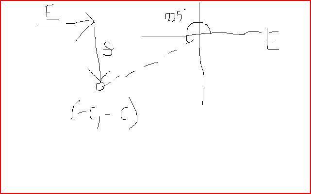

A car, initially going east ward, rounds a 90 degree curve and ends up heading southward. If the speedometer reading remains constant, what's the direction of the car's average acceleration.
a = Δv/Δt
vi = (c,0)
vf = (0,-c)
(vf - vi )/Δt =(-c,-c)/Δt

Is there a question here? This result looks correct. If they are asking for the direction, it's SW.

My answer tallies with the book except that instead of SW, I chose my answer in the form of Cartesian coordinate-much more empirical and non-arbitrary to me.
So relative to the East and using the x-axis as East direction, the car is 225°
... do you mean to ask if this is correct?
Do you mean 225deg clockwise or anticlockwise from East?
A compass bearing would be an angle measured clockwise from North, or it would be a name like "due N" or "NNE".
225deg clockwise from due E would be NW - a bearing of -45deg.
It is good practice to put the answer in the same terms that the question used ... so I'd pick "NW" rather than "-45deg" as the more appropriate of the two. It will make a difference to you marks in the coming years and to your employment prospects later.

Sorry, I mis-typed it. It's 225° from the + x-axis.
That made sense.
Yes. Is this angle clockwise or anticlockwise? When you give this kind of answer in an exam, you have to say.
If you gave the compass direction, instead, it would be clear.
Was my compass direction "NW" correct for the direction of the average acceleration?
SW.
It's just strange that in Calculus class I didn't have to deal with the bearings. It would be implicitly assumed given that 225 is in the third quadrant and the convention was the +x-axis was the reference point.
Actually it is an arbitrary convention common to many calculus classes, that the angle is taken anticlockwise from the +x axis ... just like you commonly use the right-handed Cartesian coordinate system. But that's only a convention and it will not be the same everywhere. Even in calc, different coordinate systems will have different definitions ... spherical polar has two angles for instance.
Part of the question is testing to see if you can work with different conventions.
