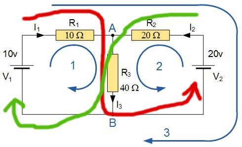

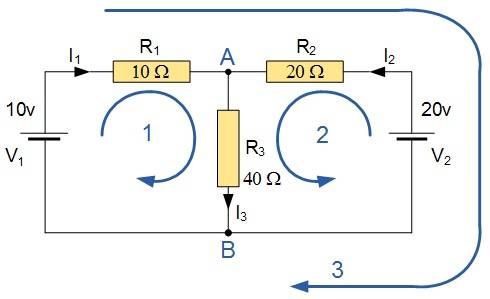

I'm going through Kirchoff's second law, and stumbled across this example on this page:
In the image above, you can see that the blue arrows (both arrow 1 and arrow 2) indicate the direction that the current goes in. However, I am wondering why the current cannot go as per the red and green arrows depicted in the image below?
What stops the electrons from going from Negative end of 10V battery to positive end of 20V battery (as per red arrow)? What stops them going from negative end of 20V to positive end of 10V (as per green arrow)?
Any help much appreciated.

Nothing. The current (not the electrons) goes wherever it needs too go. In your first example, the current arrows does not indicate where the current goes, they are just indicators that you are going to use when calculating the currents. If one of the current turns out to be negative - you just guessed wrong and the current goes against the arrow.

But it's not wrong to get negative currents. How you choose the direction of currents in circuit analysis is arbitrary. Maybe it's intuitive to have only positive currents, but it's not necessary. For AC you have anyway time-dependent currents with positive and negative values like ##i(t)=i_0 \cos(\omega t)## :-).

Hold on a min folks. I agree that it doesn't matter if 1) or 2) are clockwise or anticlockwise as long as you are consistent but...
In the first image the arrows 1) and 2) show the currents going right around their respective loops. For example 1) goes from the +ve of the 10V battery all the way around the left hand loop back to the +ve of the 10V battery. eg back to where it started.
In the second image the currents don't go around a loop at all. The red arrow starts at the +ve of the 10V battery and ends at the -ve of the 20V battery. It's not a closed loop. I don't think that works at all as far as Kirchoff's second law is concerned. However if someone wants to prove me wrong...
Edit: If you look at the 10V battery the current leaving the +ve terminal is the red current. The current entering the -ve terminal is the green current. That implies the red and green currents must be the same value which clearly doesn't have to be true.

This cleared a lot of it up! Thanks!
Indeed the loop must be closed. What you do there is just to integrate Faraday's Law over a surface ##S## with boundary ##\partial S## (which is necessarily a closed loop), using Stokes's theorem
