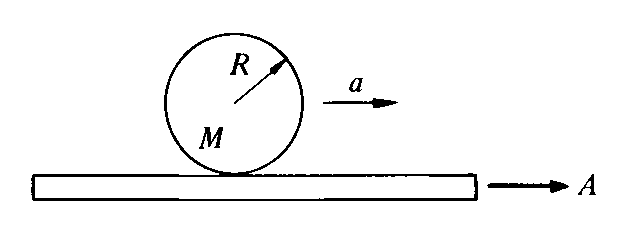

A cylinder of mass M and radius R rolls without slipping on a plank
that is accelerated at rate A. Find the acceleration of the cylinder.
Physical force acting on the system : Fphy = N + mg + fr
w.r.t. plank frame i.e non - inertial frame,
1) the cylinder has pure rolling motion.
2)Net force acting on the cylinder : F(cy,n-in) = Fphy + Fpseudo
3) |a(cy,n-in) | = |α(cy,n-in)| R
What is the direction of friction ?
The cylinder is rolling clockwise. So, α and Γ are along - ## \hat z ## direction.
Now, the only force providing torque is the friction force.
fr Ξ fr ##\hat x##
Now, the torque about the center of mass is Γ = R(- ##\hat y##) × fr ##\hat x## = |Γ|(- ##\hat z##)
Rfr ##\hat z## = |Γ|(- ##\hat z##)
fr = -|fr |
This implies that the friction is acting towards left.
But the bottom part of the cylinder has a tendency to move towards left and friction force will oppose this relative motion. So, the friction will act toward right.
I am getting two contradictory answers. Where is it wrong?

I think I got the mistake.
It is in this statement:
Pushoam said:
The cylinder is rolling clockwise. So, α and Γ are along - ##\hat z ## direction.
"The cylinder is rolling clockwise " implies that the angular velocity is along - ##\hat z ## direction. It doesn't give any information about the direction of α and Γ.
So, I have to find direction of friction in the following way:
So, the friction is fr = fr ##\hat x##, fr >0 N
Now, the torque about the center of mass is :
Γ = R(-##\hat y##) × fr ##\hat x## = Rfr ##\hat z## = Iα ##\hat z## = (##\frac {MR^2} 2 ##) (a (cy,n-in)) /R ##\hat z##
Rfr = (##\frac {MR^2} 2 ##) (a (cy,n-in)) /R
fr = ½ M|a (cy,n-in) |
Note that as α is anticlockwise, a (cy,n-in) = |a (cy,n-in) | (-## \hat x##)
From Fphy = N + mg + fr , we have
fr = Mai, w.r.t. inertial frame
So, ai = ½ |a (cy,n-in) |
From
F(cy,n-in) = Fphy+ Fpseudo we have
|a (cy,n-in) | (- ## \hat x ##) = ai (## \hat x ##) - A (## \hat x ##)
-3 ai = -A
ai = ⅓ A
a (cy,n-in) = -2(⅓ A)
Is this correct?

You seem to claim the angular acceleration of the cylinder is the linear acceleration over R?
Think about if the linear acceleration of the cylinder was zero... wouldn't the cylinder still need to rotate in order to not slip?
Oh, sorry, I did not realize you were working partially in the inertial frame and partially in the accelerated frame.
I agree with your result, a=A/3
