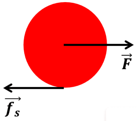

This is not really homework, I just want to understand the direction of friction for rolling object.
Please see the picture below
None
A force is given to the center of the object so the object rolls to the right without slipping. I understand that to provide clockwise rotation the static force should be directed to the left.
But if the force F is located at the very top of the object, the static friction is directed to the right. I don't understand why.
At first I thought because the rotation is clockwise then the object will exert backward force on the ground so the ground will exert forward force to the object but it seems this reasoning can not be applied if the F is at the center.
So when F is at the very top, why the static friction is directed to the right?

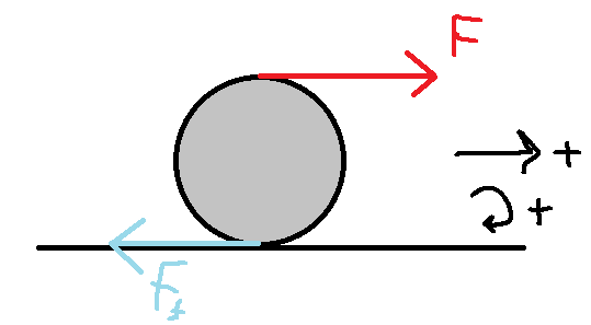

No, @songoku is correct. If the driving force is near the top of the disc then the static friction will be in the same direction.
The reason is that a force applied that far from the disc centre will exert such a high torque about the disc's centre that it will tend to create more angular acceleration than is needed to match the linear acceleration.

One can also do like this. Assume ##\vec{F}_f## is directed to the left when force applied on top (assuming a solid cylinder shape, you can redo this analysis with any object having moment of inertia of the form ##kmR^2## where ##k## is a positive number)
Let ##F## and ##F_f## be the horisontal components of the respective forces.
##F-F_f = ma## equation (1)
##FR+F_fR = I\alpha = \dfrac{mR^2\alpha}{2} ## equation (2)
Rolling without sliding: ## a = \alpha R##
(2) becomes ##F+F_f = \dfrac{ma}{2} ## equation (3)
Now, solve the system of equations (1) & (3) for ##F## and ##F_f##. You will find something peculiar, what does it mean?
After this, consider that general moment of inertia that I gave you.
And finally, move the point of acftion of F so that its distance from the center is r/R where -R< r < R, and do the analysis once more. What will you find?

You mean if the friction is to the left then ##a=\alpha R## would be violated? It would become ##a<\alpha R## so rolling without slipping is not possible?

The ##F_f## would be negative so it means that the direction should be to the right.

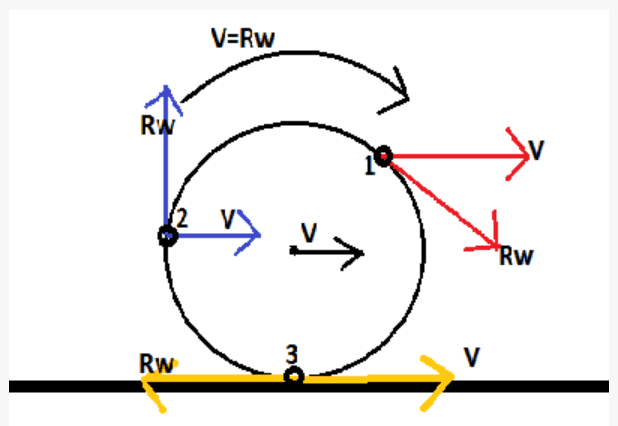

I am not sure what kind of pictures you mean. I can imagine the two velocities at the bottom of the object pointing to opposite direction and have different values but I can't use the information to analyse the motion
Likes Delta2
A picture of an object that rotates and slides, with arrows indicating direction of translational movement and rotation respectively.
You mean like this?
