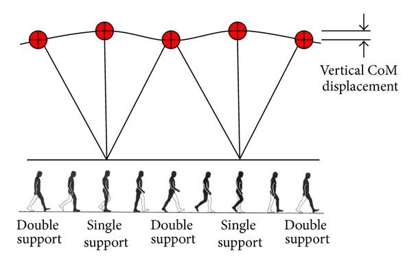

Will you please explain where actually the force due to friction acts while a man is walking forward.
I am really confused with a lot of confusing things in the internet.
I am unable to give a fixed answer to my students.
I saw somewhere that friction acts in forward direction, please explain it to me.

When you are walking forward, the bottom of your rear foot exerts a backward frictional force on the ground. The ground exerts an equal and opposite forward force on your rear foot. This force moves you forward.

He is asking about normal walking, not sliding around. In normal walking there is no relative motion between shoe and ground during most of the stance phase. The horizontal ground reaction force is static friction, not dynamic friction. Its direction is the same as the horizontal acceleration of the body's center of mass.

Only in the late stance phase. In the early stance phase it is the other way around, and you are braking. See diagram from above link:

If your final horizontal speed equals your initial horizontal speed, the integral is only slightly positive due to air resistance.

Work is not everything. Momentum conservation still applies. At constant average speed the horizontal momentum transfer from the ground, must cancel the horizontal momentum transfer to the air.

Thinking a bit more, from the free body diagram for the human, the time-average friction force on the ground + the time average horizontal air resistance force = 0, for constant average walking velocity.
(And that seems like a different way to state A.T.s momentum transfer argument).
Human walking can be modeled as an inverted pendulum. Without air resistance and muscle action, the horizontal ground reaction force (friction) would be a perfectly symmetrical back/forward profile and sum up to zero during the stance phase.
In reality there is damping and propulsion by the muscles.
