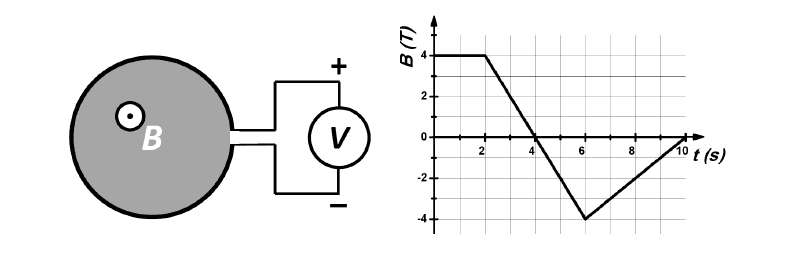

The problem is simple, all I have to do is draw a voltage / time graph. The black ring is a conductor, its inner surface area is 0.01 m^2. The magnetic field points upward, B = 4T.
2. The attempt at a solution
I understand what I have to do, but I'm getting the wrong +/- sign. So I would just like a sanity check.
In the first decreasing interval, from t = 2 to t = 6. The flux is decreasing, so the magnetic field produced by the ring should be pointing upwards. Therefore the current in the ring should be counter clockwise.
If the current is counter clockwise, the voltage should be positive on the given voltmeter. However, the voltage in the solution is negative. The problem states that the voltage is positive when electrical potential is larger on the "+" side of the voltmeter.
I think it has something to do with the agreed and the actual direction of electrical current, so someone just please tell me what I am thinking wrong.

Replace the Voltmeter with a resistor. Which end of the resistor will be at the higher potential ?
The concept of electric potential is not very useful in circuits with changing magnetic fields. For example, suppose you have the circuit shown below which consists of two voltmeters.
The positive and negative terminals of the meters are indicated by the + and - signs. There is a magnetic field in the gray area that points out of the page and is decreasing in magnitude. You can’t say that point a is at a higher (or lower) potential than point b. But that doesn’t matter. You can still tell which way the current is going to flow through each meter. It’s the direction of current through a voltmeter that determines whether the meter registers a positive or negative value.

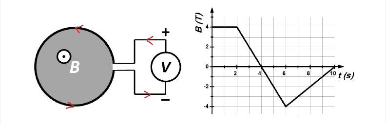

I know this, the potential thing was defined in the task, not sure why. This still leaves me with the problem.
The current flows counter clockwise, right? The agreed upon direction (+ to -) is generaly used in magnetism. So this is the flow:
So shouldn't this give a positive value? The current flows from the positive to the negative.
Regarding your example,
This is the flow, so the ljeft voltmeter is negative, and the right one is positive. At least that's how I'm going about all this.
So please, tell me what's wrong here.

Update: I believe I've figured out what's wrong.

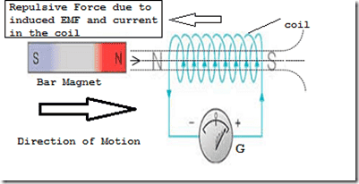

It seems that voltage is actually positive when it goes into the + pole first. The reason I thought it was opposite is this picture:
and some others, portraying the same thing.
So, in the picture, are they just using the actual direction of current (- to +) or might it be wrong? Or is there something I still have wrong?
Yes, it might just be a case of them being careless. It looks like that mistake would be easy to make for a variety of reasons.
In regards to your original analysis, I think the most important issue is that you did get the correct direction for the induced current in the ring.:smile:

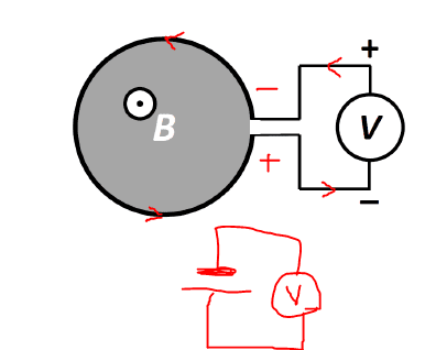

So all I got wrong is how voltmeters work? I usually don't look for the direction of current when figuring out voltmeters, just poles. What confused me is that the metal ring is like a power source, so electricity doesn't flow from the positive pole to the negative, but the other way around. Is this a correct depiction of the poles on this thing:
Yes, I believe so. You got the current direction right.
If you want to think of the ring as the "source of emf" for the rest of the circuit (the voltmeter part), then your assignment of + and - poles for the "source" looks correct in this case. The current runs from "+ pole" to "- pole" in the voltmeter part of the circuit and it runs from "- pole" to "+ pole" inside the "source", just like a battery acting as a source (as you indicate).
