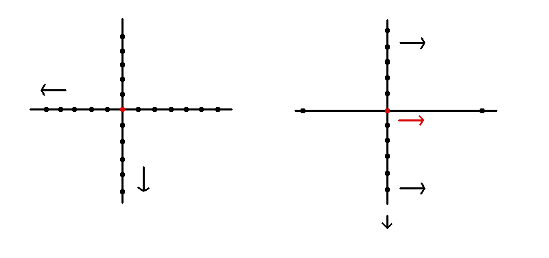

Left picture: There are two moving rails that cross at center (red dot) which itself doesn't move. The rails speeds are close to c, so that they are length contracted by factor 10 (roughly 0.995c). There are markings in rails at interval 10 length units in rails rest frame, so the interval is only 1 length unit in this frame. Markings from both rails meet the center simultaneously.
Right picture: The same from horizontal rail's rest frame. The whole vertical rail and center are moving right at speed approx. 0.995c. The vertical rail has also some velocity in y-direction downwards, but considerably less than c, about 0.1c by my approximations. In right picture, the markings of horizontal rail are at interval 10 length units (not in scale, but should illustrate the idea) because this is horizontal rails own rest frame. But the markings of vertical rail are at interval 1 (or at least close) also in this frame, which can be seen e.g. by that y-velocity is only 0.1c and markings from both rails must meet center simultaneously also in this frame.
Maybe there is no problem, but I'm curious that the vertical rail seems to be strongly length contracted also in the frame of right picture, although the vertical rail's velocity is mostly horizontal and only slightly vertical in this frame. I would expect that length contraction happens only in the direction of the motion, which would mean that vertical rail shouldn't be much length contracted in y-direction.
Maybe I'm seeing this wrong, but are you sure your right hand diagram is equivalent to the left one? It seems to me the arrows representing the direction of the moving rail in the right hand picture should be pointing South-East, not East. As you draw it, the crossing point is stationary on the vertical rail frame, but it was moving in that frame in the lefthand picture.
(Hope this is clear...if not I'll try a better formulation)
Please show your work. This doesn't look right to me. There will be some effect on the vertical rail's y-velocity, but I think it's much less than you are estimating; the vertical rail will still be moving at a highly relativistic speed in the horizontal rail's rest frame. [Edit: no, actually the y-velocity is unchanged by a boost in the x-direction.] [Edit again: see follow-up posts.]
Yes, that is the idea, but I "separated" the velocity components. So the movement is south-east, but mostly east.

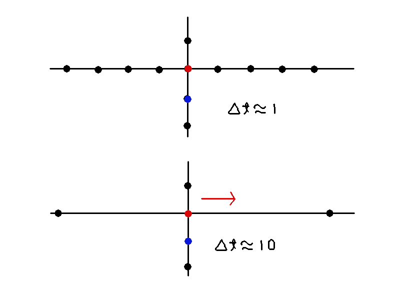

Here is a picture about the value 0.1c. I don't draw all the arrows, because it would be messy, but the motion is the same as in previous picture.
Upper picture is in crossing's (red point) rest frame. Blue point is a clock that is stationary and synchronized with the crossing, the distance between crossing and clock is 1 length unit. Vertical rail markings are moving down and ##\Delta t## is the time one marking takes moving between crossing and clock. It's about 1 time unit, slightly more, because the speed is slightly below c.
Lower picture is in horizontal rail's rest frame, where crossing and clock are moving horizontally with approx. 0.995c. Red and blue clocks are still synchronized and their distance is not changed by motion, because horizontal motion does not affect either. Vertical rail marking takes time approx. 1 unit (slightly more) moving between red and blue clocks, according to these clocks, but as in the outside frame the clocks are slow by factor 10, one marking takes approx. 10 time units (slightly more) to travel from red clock to blue clock. That gives the speed quite close to 0.1c. I think this accuracy is enough, if this is otherwise correct.

This argument assumes that whatever is reflecting the light pulse is not moving vertically. More precisely, it only deals with one reflection, so the vertical motion of the reflector is irrelevant. Try looking at multiple reflections where the mirror is moving vertically, and seeing how the mirror's vertical velocity transforms. Or you could just look at the correct formula for relativistic velocity addition, in the case where the boost velocity (from one frame to the other) and the velocity being transformed are orthogonal:
http://en.wikipedia.org/wiki/Velocity-addition_formula#Special_case:_orthogonal_velocities
Plug ##U = 0.995c## and ##V = 0.995c## into the formula and see what you get.

From the picture, the vertical rail is moving down, the horizontal rail is moving to the left.
That's about what I get, the drawing is confusing because you don't show the downward component, the arrows pointing to the right on the vertical rail should point to the right (mostly) but also down slightly.
I believe that the vertical rail remains vertical, and the vertical spacing remains the same, but it was a rather hasty calculation that I don't want to go into the details. Basically, though, you'd want to write the equations of motion of at least 4 dots, then lorentz-transform them appropriately.
yes
That's what I'm currently getting.

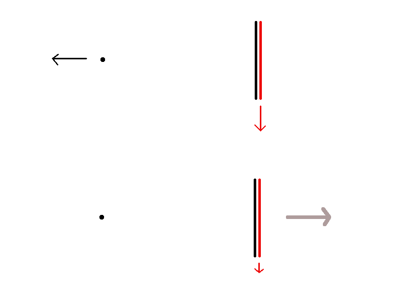

Here is a simpler version demonstrating the same problem, or maybe there is no problem, just that the direction of length contraction is not as straightforward as someone (at least I) might expect.
The upper picture is in black rail's rest frame. Black rail's proper length is 1. The red rail is moving down relative to the black rail at v that corresponds Lorenz-factor 10, approx. 0.995c. Red rail's proper length is 10, so it's contracted length in this frame is 1. The black and red rail actually have the same x-position, but they are just drawn side by side to get both visible. Let's fix the origin at the center of black rail and t=0 so that the ends of the rails meet. There is also an observer (black dot) that moves at the same speed v to left. The world lines for the rails in this frame are:
##(t,x,y) = (t,0,0.5)## black rail's upper end
##(t,x,y) = (t,0,-0.5)## lower end
##(t,x,y) = (t,0,0.5-vt)## red rail's upper end
##(t,x,y) = (t,0,-0.5-vt)## lower end
The lower picture is in the black dot's (i.e. observer's) rest frame. The thick grey arrow indicates that the system of rails is moving to right at v relative to the black dot, and there is also red arrow saying that red rail has some down-velocity relative to the black rail. We use equation for Lorenz-boost to left, which is ##(t',x',y')=(\gamma(t+vx),\gamma(x+vt),y)##. We need to substitute the world lines into the boost equation and use ##\gamma=10##, as it was defined that v corresponds to this value, and get the world lines in this frame:
##(t',x',y') = (10t,10vt,0.5)## (black upper)
##(t',x',y') = (10t,10vt,-0.5)## (black lower)
##(t',x',y') = (10t,10vt,0.5-vt)## (red upper)
##(t',x',y') = (10t,10vt,-0.5-vt)## (red lower)
And by using ##t'=10t## get
##(t',x',y') = (t',vt',0.5)## (black upper)
##(t',x',y') = (t',vt',-0.5)## (black lower)
##(t',x',y') = (t',vt',0.5-0.1vt')## (red upper)
##(t',x',y') = (t',vt',-0.5-0.1vt')## (red lower)
By using t'=0 we see that that the black and red rails are equally long in this frame, which means that the red rail is length contracted by factor 10 also in this frame. And from y-coordinates of the red rail we see that its y-velocity is only approx. 0.1c. So the question is why the red rail is length contracted by factor 10 in y-direction, although its y-velocity is only 0.1c.

Careful! That equation is not a valid Lorentz transformation; it only holds for an event at the spatial origin, i.e., if ##x = y = 0##. That is certainly not true for the events you are transforming.
Let t'=1 => t=0.1 and we get the events
(1,v,0.5)
(1,v,-0.5)
(1,v,0.5-0.1v)
(1,v,-0.5-0.1v)
For t'=0 => t=0 we get
(0,0,0.5)
(0,0,-0.5)
(0,0,0.5)
(0,0,-0.5)
Then, get "event at t'=1" minus "event at t'=0", respectively for each of these four, and we get velocity vectors (I guess that's the term)
(1,v,0)
(1,v,0)
(1,v,-0.1v)
(1,v,-0.1v)
Then construct the lines. Use the information that line goes through the event at t'=0, and use the velocity vector multiplied by arbitrary ##a \in \mathbb{R}##. The lines are
(0,0,0.5) + a(1,v,0) = (a, va, 0.5)
(0,0,-0.5) + a(1,v,0) = (a, va, -0.5)
(0,0,0.5) + a(1,v,-0.1v) = (a, va, 0.5 - 0.1va)
(0,0,-0.5) + a(1,v,-0.1v) = (a, va, -0.5 - 0.1va)
and using symbol t' instead of "a" we see that these are in fact the same as we already had in #20. So there is not really difference in this case, but I tried the same setting x=1 instead of x=0 in the frame of rails (frame F) and checking how it looks in the moving frame F', and the time component was indeed more complicated than t'=10t.
