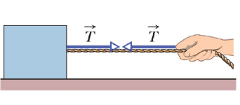

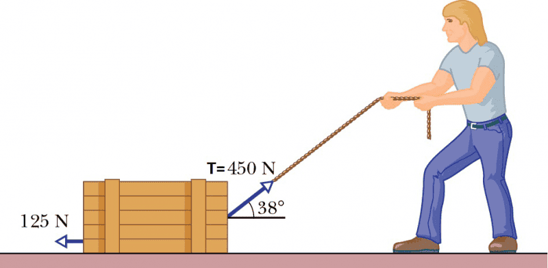

Hello , which of the following has the correct T direction?
Depending upon the object being analyzed, I'd say they are all correct.
The first diagram shows the tension acting on the box and the tension acting on the hand. Both correct.
The second diagram shows the tension acting on the box. Looks OK to me.
Realize that in common usage, "tension" refers to the force that the rope exerts on whatever it is pulling. That can be confusing at times.
To emphasize that point, we can say that "tension" is not a force. "Tension" is property of a rope that can be used to deduce forces at many different places. So there are different force vectors that are "due to tension".
The direction of a force due to tension depends on whether we are considering the force exerted by the rope on something or the force of something pulling against the rope (i.e. what we are considering to be the "free body" in a free body diagram). So "tension" is not a vector. It is the forces due to tension that are vectors.
Of course, it's common for people talking about a physics problem to pick a particular force vector and call it "the tension" instead of saying it is "a force due to tension". Common speech in inexact.
