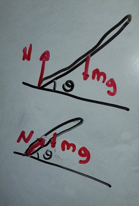

The picture shows the two cases of the normal force. I would say the the first one is the correct one, since the Normal force is normal to the surface. But the second one makes me think that, as the normal force has a component on x, this would make the friction force come into play.
Thank for the schematic.
That body is not in equilibrium, there is a moment created by the normal force and the weight.
The resistive force of friction can't exist without the tangential component of the reactive force of contact between both surfaces.
One is the cause, the other is the effect.

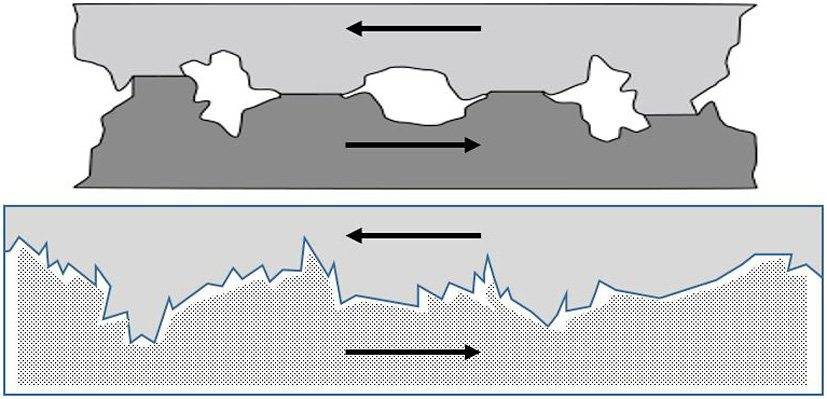

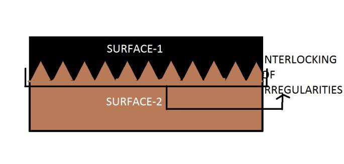

Simplifying a very complex phenomena to the extreme, I would suggest trying to understand the basic principle behind normal force related to static friction in the following crude and very far from academic way:
In orther to start relative movement betwen the surfaces, the tangential force must do the required work to "lift" the body from the surface.
The magnitude of the required force to do that work is what we call static friction.
The direction of that minimum required force is more or less perpendicular to the plane of contact of the two surfaces.
Static friction happens only because there is a "locking" mechanism between the body and the surface, and because there is a "clamping" (normal) force that keeps them "locked".
Quite so, assuming it is a flat level floor. Any force parallel to the floor would come from friction.
The second picture is wrong even if we change the force designated N to mean the total reaction from the floor. It will not line up with the ladder.
If we count just three forces, gravity, reaction from floor, reaction from wall, then torque balance requires that the three lines of action pass through a single point. For the diagram to be correct, the reaction from the wall must also be in the line of the ladder. But the horizontal components of those reactions must be equal and opposite, making their vertical components also equal and opposite. So now we cannot balance the vertical forces.
