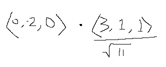

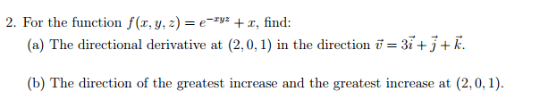

part a) finding partial derivatives:
and plugging in (2,0,1) into each, I get the gradient which is <0,-2,0>
to find the directional derivative, it is the dot product of the gradient and unit vector of (3,1,1):

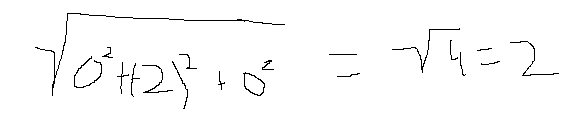

part b) isn't the direction of the greatest increase just the gradient, which I found in part A?
and the greatest increase at (2,0,1) is the magnitude of the gradient there, which is

Some of your partial derivatives are incorrect (although not by very much).

One of your partial derivatives is wrong.

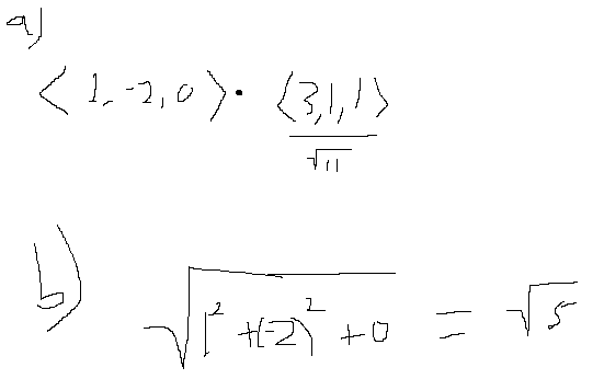

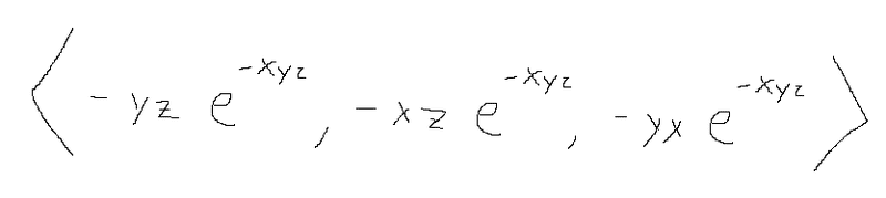

wow, I can't believe I didn't spot that +x at the end.
it should be (-yz e^-xyz) + 1
the correct answers after fixing the partial derivative with respect to x
