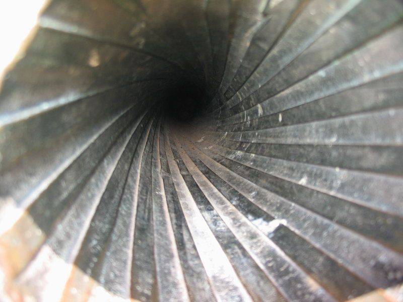

Hey everyone! My name is Jing and I am participating in a one month summer program called SHAD where 800 high school students across Canada come together to try and solve some of the world's most multi-dimensional problems. One of the aspects of this program is the Entrepreneurial Project, where groups of SHAD participants innovate a solution to these kind of problems.
This year's theme is every consumption, and one of our group's ideas is to create a new type of pipes which has swirled grooves on the interior to better permit water flow and limit turbulence. A picture of the interior of a rifle is shown below to help illustrate what I am trying to convey:
url
My question is whether or not this is a feasible idea and if it can be effective in reducing energy losses in the water across long distances.
Thanks for any help in advance!

What is your thinking behind why the grooves will reduce the turbulence and energy loss?
Hey, thanks for replying to my thread.
Our thinking was that by giving water a guided path to flow along, there is a lower chance for flowing water to divert from a path parallel to the pipe and collide against the smooth interior surface of the pipe. Therefore with less collisions, more kinetic energy is preserved.

Ok, not bad - but have you looked into whether or not that is a significant source of energy loss for flow in pipes?
Heya, thanks for replying.
It's definitely very important for our group to include the scale of the energy losses that can be achieved through this method. We haven't personally looked into the energy losses due to friction/turbulence in pipes yet, but we are in the process of contacting mechanical engineering and physics professors at our host university for guidance on involving fluids and energy losses.

This one should be pretty easy to find with google...

Don't forget the Reynolds Number. That's perhaps the key measure in this research.

That equation is useless in fluids.
