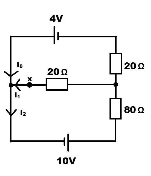

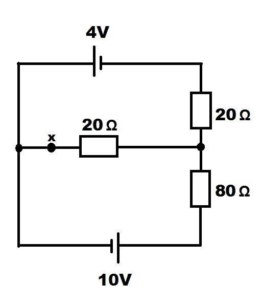

Apply Kirchhoff's laws to find the current at point X in the circuit shown. What is the direction of the current?
V = IR
Kirchhoff's 1st law: ∑Currents entering junction = ∑Currents leaving junctions
Kirchhoff's 2nd law: ∑EMFs in a loop = ∑PDs in a loop
This problem is simple enough but my issue is how to tell initially which directions the currents are going in. My initial approach was as follows:
However, this leads to incorrect answers:
By Kirchoff's 1st law, I2 = I0 + I1
By Kirchoff's 2nd law, the sum of the emfs in the top loop must equal the sum of the pds:
EMF = 4V
PDS:
V = IR, V = 20 x I0
V = IR, V = 20 x I1
So 20 x I0 + 20 x I1 = 4
Using I2 = I0 + I1 from earlier,
20 x I2 = 20 x I0 + 20 x I1
substituting this into 20 x I0 + 20 x I1 = 4
gives 20 x I2 = 4
I2 = 4 / 20 = 0.2A
Applying Kirchhoff's 2nd law to the big loop (ie ignoring middle resistor):
EMF = 10 + 4 = 14V
∑PDs = 80 x I2 + 20 x I0
80 x I2 + 20 x I0 = 14
80 x 0.2 + 20 x I0 = 14
I0 = -0.1A
I2 = I0 + I1
I1 = 0.2 -- 0.1 = 0.3 A which is not the correct answer.
Why should labelling the currents in this way not give the correct answer?
In these problems, if the assumed direction of the current is incorrect, the value obtained should just be the negative of the actual current magnitude. I haven't checked the set up of your equations, but there may be other problems there.
This equation is not correct. You have a sign wrong.
Once you have assigned directions to currents, you must pay close attention to polarities of associated potentials.
