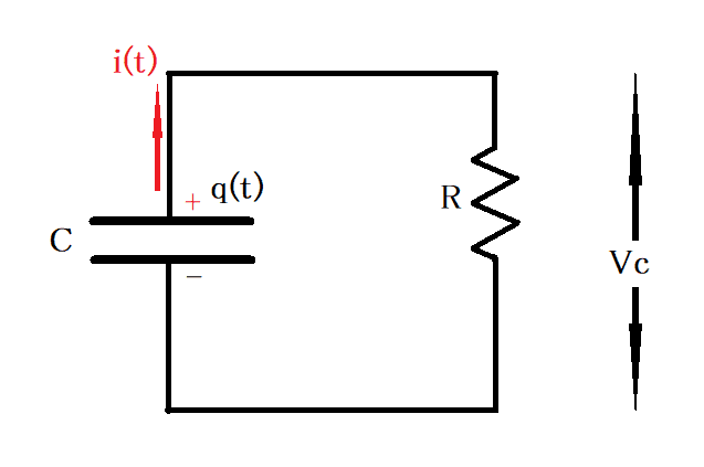

Hi everyone!
I'm trying to understand why when writing the differential equation of a discharging RC circuit [itex]V_C-Ri(t)=0 \to q(t)/C - Ri(t)=0[/itex] we replace [itex]i(t)[/itex] with [itex]-\frac{dq(t)}{dt}[/itex].
I read many threads but I don't understand the physics behind this. The usual answers I read are something like "by using the passive sign convention" or "because the current must be positive".
I'd like to solve this problem because it is driving me crazy!
You need to sketch the circuit and label the variables.
244828
So look at the way you have i and q labeled in your drawing. Does a positive i lead to an increase in q or a decrease?
Doesn't it lead to an increase of charge in the circuit and an equivalent decrease in the capacitor?

I can't disagree with you all, but I still don't understand the choice of a negative [itex] I(t) [/itex]. As sophiecentaur says we have to believe in maths but if so, why should we put a negative sign? A derivative is just a mathematical tool that expresses the change of something, and as such, it has an implicit sign depending on the change of [itex]q(t)[/itex] in [itex]t[/itex].
Maybe my problem is that I don't understand what [itex]q(t)[/itex] really means. I'm very sorry for being too stubborn, but I do really like physics and I want to understand every choice that is made to derive equations.

If I use KVL in the circuit I sketched, I get that the voltage across the capacitor must be the same as the voltage across the resistor [itex]V_C=V_R[/itex] hence [itex]V_C-V_R=0 \to q(t)/C - I(t) R=0[/itex]. Am I wrong?
How can I 'see' the other current you talk about and what causes it? Could you add it in my sketch, please?

Looks good to me. I think we are making this harder than it needs to be.
In my analysis of this circuit, there is only one voltage and only one current. I tend to skip the step Vc=Vr and Ic=Ir. You can arbitrarily assign voltage and current polarities, but then you have to be careful about defining the relation between V and I at each circuit element. Sometimes V=IR, sometimes V=-IR.

Look in any textbook and see how it's done. As @DaveE says, you seem to be over thinking this. If one terminal of the C is + then that defines the direction of the (conventional - of course) current. There's nothing more to it.

I still don't understand the choice of a negative I(t) .
There is no real reason for it. Whoever drew the figure drew i as leaving the + terminal, so i decreases q. If they had instead drawn the figure so that i was entering the + terminal then i would increase q so the sign you are confused about would be positive.
There is no fundamental physics reason why it is negative. It is purely due to how the author chose to draw and label the current and voltage in the figure.
