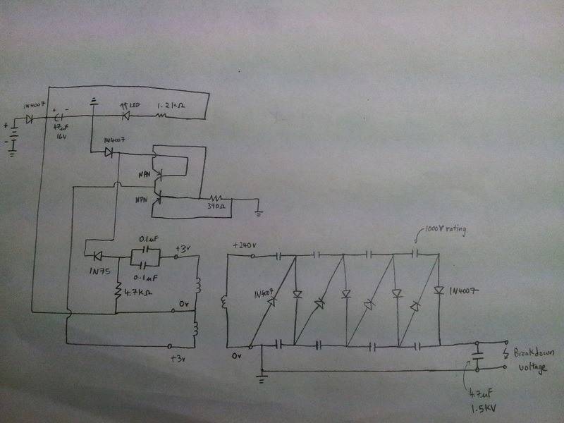

I have been working on a circuit (similar to car ionizer circuit) for a pulsed plasma thruster, which is able to charged up a capacitor to voltage as high as 1.8kV. I have a diode which is able to block reverse voltage up to 2kV interfaced between the charging circuit and the discharged capacitor.
This capacitor is then connected to two electrodes (air gap) that discharge when the breakdown voltage is reached.
The problem is, whenever the capacitor discharges, a random component in my circuit will be spoilt. What must i do to overcome this problem?

Do you have a schematic?
Hi there, attached is the schematic. Hope it helps =D

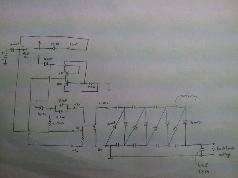

hi all, I'm coming from a mechanical background and was tasked to carry on an electronic project.
Attached is the schematic of the circuit, i tried looking up the net on the respective components and understand how each component works.
I also understand the part after the transformer which is a voltage multiplier circuit, which steps up the 240v from the transformer to several folds.
However, i do not understand how the circuit before the transformer actually works. Greatly appreciate any help! Thanks !

These cascade voltage multipliers work by charging the capacitors in parallel, then connecting them in series while they discharge. They are a clever design, and are most useful for low-current applications. http://en.wikipedia.org/wiki/Voltage_multiplier
I notice you have not recorded a value for the caps in your voltage multiplier.
It looks like a small high voltage generator of the sort that was used in air ionizers that plugged into a cigarette lighter.
It has a diode in the input to prodect it from the power supply voltage being reversed, and an LED to tell you that it's connected to power.
Below that are two transistors that are connected in what's termed a Darlington configuration. This allows them to work as one transistor which has much more gain than a normal transistor.
Some current passes through a resistor to start the transistors turning on. As they draw current, it passes through a transformer that couples even more drive to the transistors, ensuring they turn on completely.
While the transistors are on, the current through the transformer to the transistors will increase according to di/dt = V / L.
Eventually, the current will reach a peak where either due to the transistor's limitations, or perhaps the resistance in the transformer's winding, the current will no longer be able to increase at this point, V across the transistor will go towards zero, the transistors will be turned off by a winding of the transformer, and this will be regenerative.
A diode prevents the drive from the transformer from placing a substantial negative voltage on the base of the first transistor. This is to protect the transistor.
During the next portion of time, the transistors are off, and the energy stored in the transformer will cause it to "ring" the voltage at the collectors of the transistors will go higher than the power supply voltage during this time.
After a short time, the energy in the transformer will be depleated and the voltage on the collectors of the transistors will fall. During this time, energy may be stored in the various leakage capacitances across the transformer. This energy will tend to make the transformer ring under the power supply voltage and aid in turning the transistors on again. Thus the cycle repeats.
On the output, the combination of diodes and capacitors serve to multiply the output voltage from the transformer until it's high enough to cause ionization of air.
I believe the oscillator is termed a blocking oscillator, and the output circuit is a voltage multiplier.

Let me guess...
One of the rectifiers in the voltage multiplier typically dies?
When a voltage multiplier undergoes a hard discharge, it seends high currents through the diodes of the multiplier.
The solution is to place a physically large, high-surge resistor between the output of the multiplier and the output capacitor. This will alleviate the torture on the diodes.

hi Mike ! really appreciate for the help. Yes, most of the time, the rectifiers died on the discharge. I will try out your solution and see if it improves the situation !

For the basic power supply, I like the cold cathode fluorestent lamp (CCFL) power supplies. Small ones can be purchased through computer hobby stores for about $10. They're robust and efficient, but they don't have the voltage multiplier on the output. This has to be built seperate.
To help your supply survive discharges, I suggest an Ohmite, SM104032003FE. At 200k-ohm and 10kV withstand, this resistor will stand off the peak currents between your voltage multiplier and output capacitor. Mouser stocks these parts for about $5 as well as some high speed, high voltage rectifiers, and high voltage capacitors.
