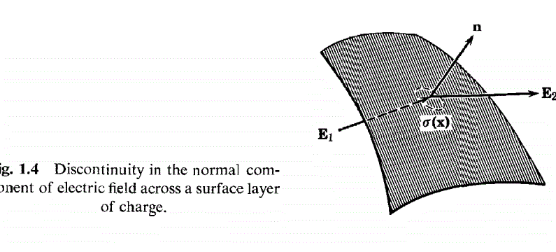

I was recently reading jackson's book of electrodynamics regarding surface charge distributions and discontinuity in electric field.
I reached that part and almost didn't understand anything.
I will write the whole text:
One of the common problems in electrostatics is the determination of electric field or potential due to a given surface distribution of charges.
Gauss law allows us to write a partial result directly. If a surface S with a unit normal ##\vec n ## has a surface charge density of ##\sigma(x)## and electric field ##\vec E_{1}## and ##\vec E_{2}## on either side of the surface, then gauss law tells us immediately that ##(\vec E_{1}-\vec E_{2})\cdot \vec n=\frac{\sigma}{\varepsilon_{0}} ...*##
This does not determine ##\vec E_{1}## and ##\vec E_{2}## if there are no other sources of field and the geometry and form ##\sigma## are especially simple.All that (*) says is that there is a discontinuity of ##\frac{\sigma}{\varepsilon_{0}}## in the normal component of electric field in crossing a surface with a surface charge density ##\sigma## the crossing being made from the "inner" to the "outer" side of the surface.
The tangential component of the electric field can be shown to be continuous across a boundary surface by using ##\oint \vec E \cdot \vec dl =0## for the line integral of ##\vec E## along a closed path. It is only necessarily to take a rectangular path with negligible ends and one side of either side of the boundary.

a) I didn't get that part:"If a surface S with a unit normal ##\vec n ## has a surface charge density of ##\sigma(x)## and electric field ##\vec E_{1}## and ##\vec E_{2}## on either side of the surface, then gauss law tells us immediately that ##(\vec E_{1}-\vec E_{2})\cdot \vec n=\frac{\sigma}{\varepsilon_{0}} ...*## ". E1 and E2 represent what? and where should I start to get this result.
##\vec E_1## is the electric field on one side of the surface, and ##\vec E_2## is the electric field on the other side of the surface.
Start by drawing a Gaussian surface as shown in the diagram here: http://hyperphysics.phy-astr.gsu.edu/hbase/electric/elesht.html

amjad-sh said:
where is the discontinuity?
The discontinuity is at the surface (where the charge density ##\sigma## is located). As you move across the surface, the normal component of ##\vec E## changes abruptly.
