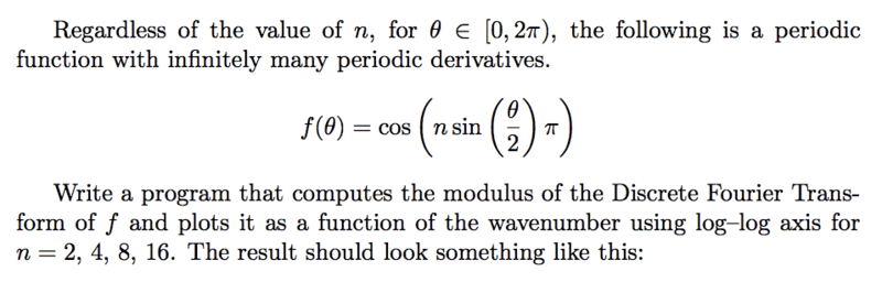

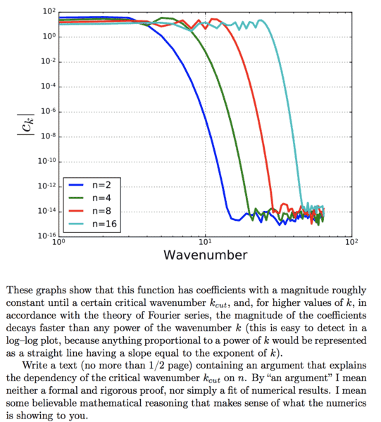

Thank you for your reply. However the values of k are given in the problem. Even the plot of ##c_k## vs k is there so I can't really change that...
collinsmark is right. You must be misinterpreting the problem. Can you share the exact problem statement you were given?
I attached it. I apologize if I misinterpret something.

The point is that both the positive and negative frequencies need to be included. For real inputs like you have, the positive and negative frequencies contain the same information, so you can ignore the negative frequencies and just plot ck for the positive frequencies. But you need to include the negative frequencies in the k array when you use it to calculate the derivative. You might try reading this description of the numpy.fft function. I've quoted the key passage below. Note that there is the np.fft.fftfreq() function that will return the k values.
"The values in the result(they mean here the k values) follow so-called “standard” order: If A = fft(a, n), then A[0] contains the zero-frequency term (the sum of the signal), which is always purely real for real inputs. Then A[1:n/2] contains the positive-frequency terms, and A[n/2+1:] contains the negative-frequency terms, in order of decreasingly negative frequency. For an even number of input points, A[n/2] represents both positive and negative Nyquist frequency, and is also purely real for real input. For an odd number of input points, A[(n-1)/2] contains the largest positive frequency, while A[(n+1)/2] contains the largest negative frequency. The routine np.fft.fftfreq(n) returns an array giving the frequencies of corresponding elements in the output. The routine np.fft.fftshift(A) shifts transforms and their frequencies to put the zero-frequency components in the middle, and np.fft.ifftshift(A) undoes that shift."

Ah, ok I understand what you mean now. However, for the first part of my question, why does that decay point depends on n, I don't need to negative frequencies. So, is my explanation correct for that? Thank you!
